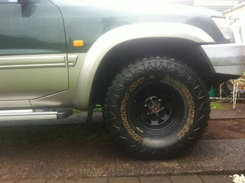

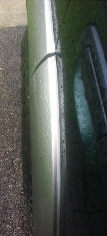

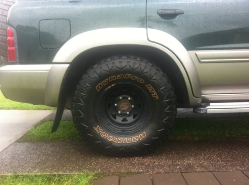

    I'm running 33/12.5/15 Hankook Dynapro M/T's on a series 1 standard suspension height, at R/H full lock with the tyre tucked up into the guard the tyre does rub a bit.
    From memory the rims are a -23 offset what people seem to refer as a Landcruiser offset, the edge of the tyre sits outside the flare a bit too.
    I think 15x10 would be a bit of overkill for 12.5 tyres, the tyres bulge out nicely when aired down i ran this set up on an old 60 series cruiser on plenty of offroad trips rock, mud sand etc and never had a problem. I had the same size M/T claws before these tyres and they were more like an 11.5 wide tyre.
    The 15x8 with that offset is a very common rim over here and they are cheap $55 each.
    I can take some pics tomorrow if you want to see them on the wagon?

    Not the best time to take these kind of pics raining and loaded up with a few hundred KG of tools but you get the general idea... I also noticed both axles are sitting off to the left side so there is a bit more meat hanging out that side. That would be why i'm getting rubbing on the right hand side and not the left...
