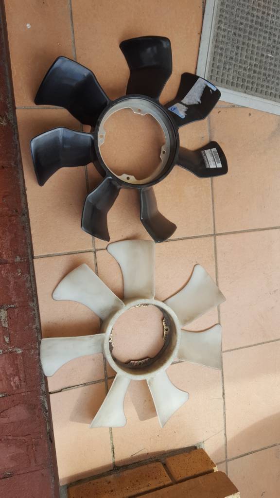

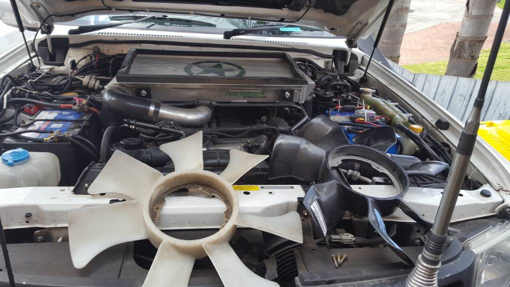

    Fitted up the infinity fan to the motor.

    Be interested to know how much that affects the cooling @Hodge approx how much for the fan?

    Will be interesting to see too mate. Most people who have it, have said it performs better. Can instantly tell it pushes air more and you can actually hear the whir of the fan, much more noticeable than the original. My motor doesn't overheat, nor do I tow or push it too much so, I don't know how it will perform at mostly idling temps, compared to say somebody whos got it fitted and does a lot of towing and the temps are on the higher scale.
    It cost me around $120AUD shipped from UAE. Thats using https://partsouq.com/ which nissannewby put me onto. Ive bought a few parts from there and saved a ton compared to anywhere local and shipping is fairly fast too.

    I found pretty much zero difference just running the fan of a stock, unmolested fan clutch. only when I added more oil in the hub I saw any cooling change. But a better fan to have none the less.

    Yes I paid $450 with the bigger hub and fan from ufi made a lot of difference, you can actually hear it.
