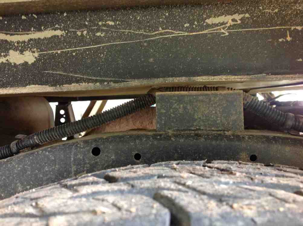

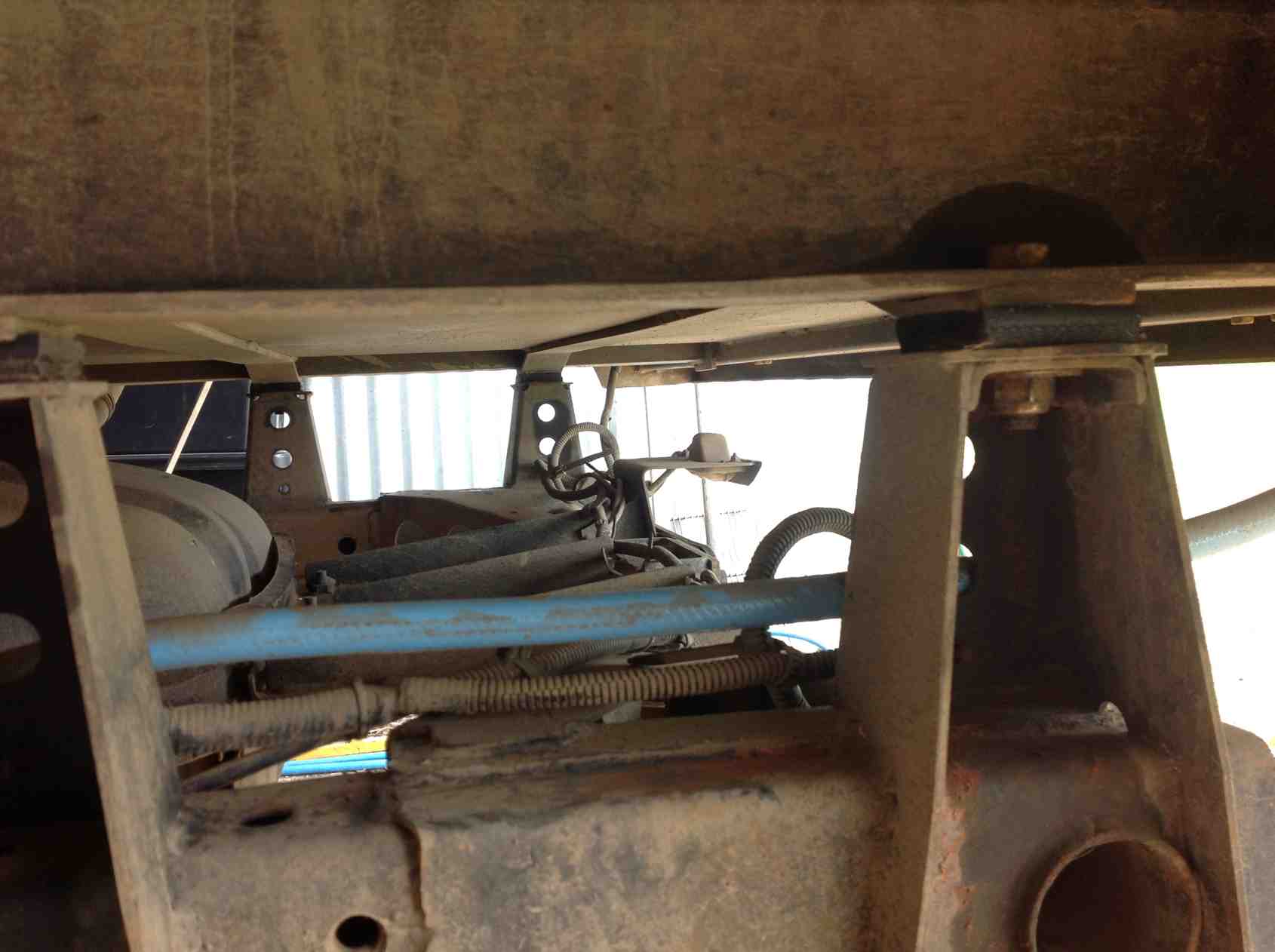

    Mine is a Rosscos pod. Could other Pod owners tell me how your pod is attached to the chassis. I get a few creaking noises when on uneven ground which I'm pretty sure is the chassis rails flexing in conjunction with the solidly mounted pod. My pod sits on aluminium pieces between pod & chassis rail. One person has suggested I should have rubber there, whilst another has told me that what I have is 'normal' & that I should expect a few creaking noises. I can live with the noise as long as I know that the pod can flex enough to take it without cracking somewhere.

    Gday cuppa mine came with 10mm rubber feet which are around 50x50. I've seen this on all the obeico pods around. I done get creaks when flexing so maybe try this.. maybe time rubber paint might fix your underbody. .

    Went into town to Clark rubber today to try to get some suitable rubber to make some 'spacers' for between pod & chassis rail. Jeez I hate going to Clark rubber, I'm sure the job description for their employees includes the ability to be permanently surly & impolite, to pretend to have product knowledge when they really know jack sh*t, & to be covered in facial pimples! I can forgive the latter, but those first two attributes really piss me off. In a so called 'specialist shop' is it too much to expect them to employ people who can offer sensible advice? Grrrrr. The strips of 'insertion rubber' of the right thickness were only available in much wider strips than I need, with a minimum length of a metre sold. Was going to cost a small fortune. They had strips of a softer dense foam rubber strip, but I thought it may compress too much or 'push out'. I ended up buying 50mm wide strip of 12mm conveyor belt material but wonder if it will have enough 'give' in it. Only way to know is to fit it & find out (unless anyone here can advise on what might be a suitable type of rubber product???). It's gonna be fun trying to make holes to take 12mm bolts in the conveyor belt material. Thinking maybe a piece of pipe of suitable diameter, sharpened at the end, heated & then pushed/punched through it. Oh what fun that's gonna be. Not.
