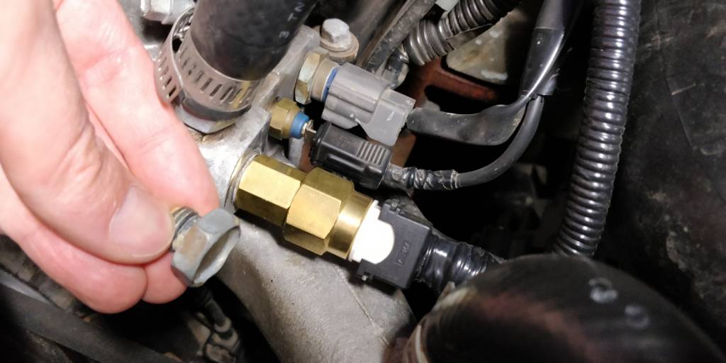

    This is the adaptor type I was looking at before I did my install, but the sensor I had was a 1/4" NPT.
    https://www.enginemaster.com.au/aero...female-1-8-npt
    I ended up getting a brass M12 x 1.5 to 1/4" NPT adaptor and cutting the male thread length down so that it screwed in flush to the thermostat housing. There were no shorter M12 to 1/4" adaptors that I could find as the thread sizes are quite a similar hole size.
    Thats how far out the sensor was sitting on mine. The sensor is no way near the water flow as it was. Even when its flush on the housing the tip of the sensor is barely in. On a side note. Can I buy that plug from you? I need this to plug up my housing.
