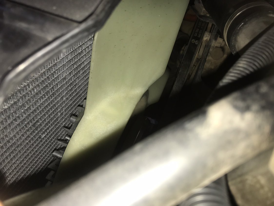

    Have you got a pic of the clearance between the fan and the radiator?
  13. #2099
    28,408
    13,850
    Pics look close but it’s 25mm
    Fans themselves are miles away.
