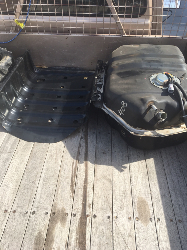

    Good score from Patrol Apart on the way through town. Late model second hand but near new condition, happy days! A few shed beers are in order tonight to try and nut out how to raise the bugger 200mm at least!
