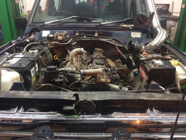

Motors in it’s fnal resting place now, got the engine a little further from the tilt it was on by moving engine mounts around. There’s 6 bolt holes in the Racebred4wd engine mount so had a few choices and a bit of trial and error.
Got my clutch and gearbox in and started fitting my exhaust, it’s getting closer now!!
