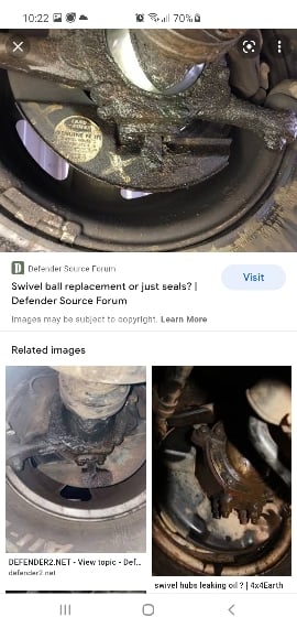

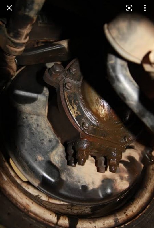

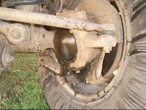

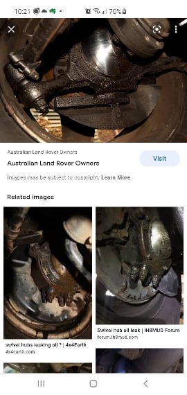

    Just for some perspective Cuppa, here are a couple of Leaks that would need immediate maintenance and I would be concerned about blowing your bearings here.
    Don't be too concerned mate. You might have 12 months in that.
