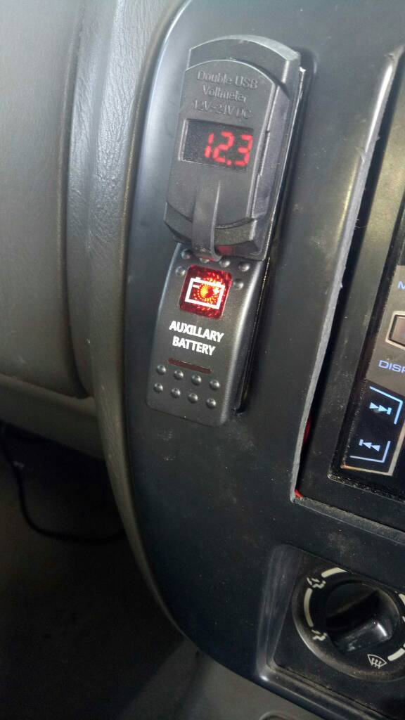

    Job done.
    Been wanting to have this set up for ages.
    Thanks @Winnie.
    Now with the push of one button headunit will power on and off without losing anything and automatically connecting my phone.
    Now need to relocate the dual USB and find my rocker with the radio on it.
