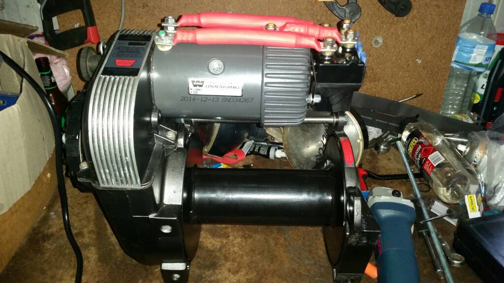

    Mine is mounted to the winch motor. So its all hidden.
    Yeah so have I.

    Yeah so have I.
    Any excuse to show it all off again! Hahah
