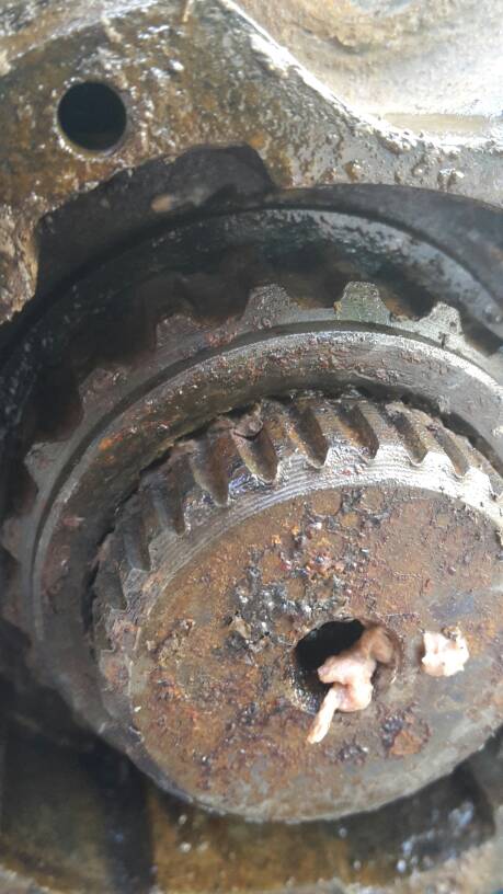

    Ok guys I know this is an old thread but as far as I can see the peice that slips onto the drive spline simply slips on?? Mine has no circlip on the outer groove but dammed if I can move it..
    Is the circlip in front of the main plate or behind it with wheel bearings??

    This is the bit which won't budge

    mine just slipped off easy as but looks like you had water in it. umm good luck try inox and clean the spline with a wire bush. no shouldn't be anything holding it in if you removed the front circlip. ( gq hubs anyway)

    Quote Originally Posted by garett View Post
    As I though. Yea it's not pretty. Tried brake clean and then freeze and release.
    Might try crc and a few taps with the soft punch to try and loosen.

    Give it clean up with a wire brush. Should just easily slide on and off.
