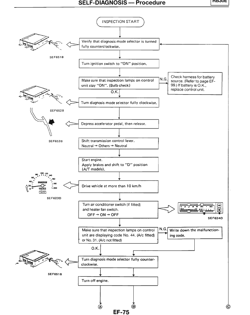

    self diagnosis. early self-diagnostic technology, useful, but it's not absolute gospel. can be handy for AFM and CAS codes
    how to do it
    i've got more from this book, i'll have to sort through it
