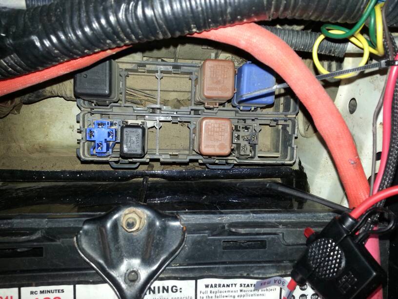

    The tb48 brake upgrade, wire in and install the lift pump and now i have decided to remove the 4way relay box in the engine bay and utilise the 5 spare spaces in the oem relay box next to the main battery. Lol

    So i went to the wreckers and bought a relay box for $30, stripped it down and now i have to graft the new wiring in from the current relays i want to add.
    But once done i thinj it will turn out good. And no extra relays in the engine bay. All in the one spot.
    All stripped and readyto work out... lol more work.

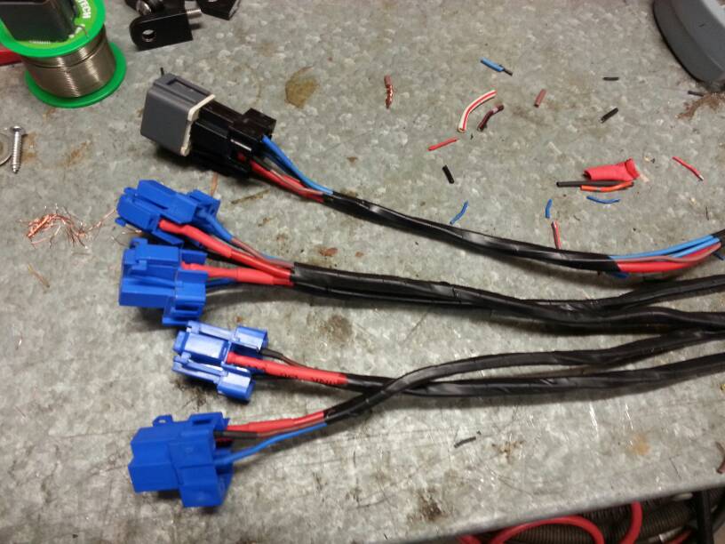

    Looms are made up and ready to go in. I just need to remove the battery and pull out the relay box for fitment of the new looms.
    I realised i have a spare 5 pin relay port in the box so i will also use this aswell for any relays that require 5 pins.
