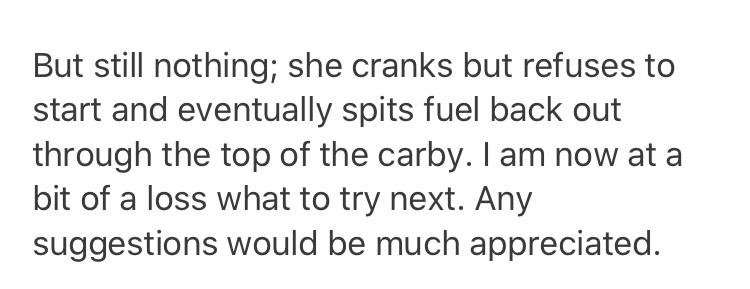

But still nothing; she cranks but refuses to start and eventually spits fuel back out through the top of the carby. I am now at a bit of a loss what to try next. Any suggestions would be much appreciated.

Plenty of things to check.
