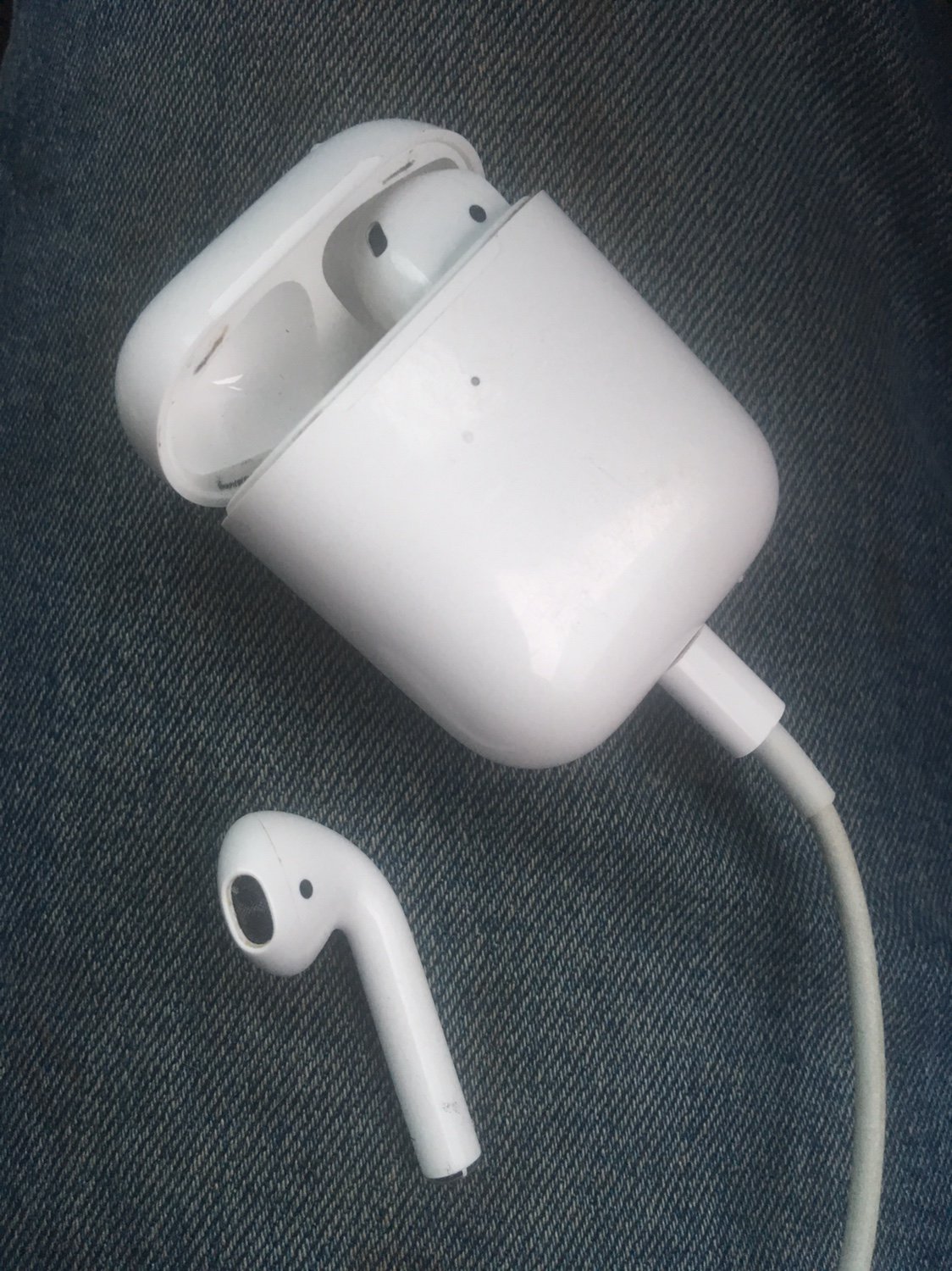

No doubt the least techy qualified someone here, but here’s my nuffy findings.
iPad old old biggin on the bush ute dash with memory mud rooftop maps kindly setup by the NP.com.au top blokes only seems to charge off an original iSteal Apple cord.
iPhone for work too spits the dummy with service station emergency bought cords also after only a short while. Needed to bluetooth earpiece work call blokes whilst bouncing away in old noisey twucks and found this wanky ripper only likes OEM charge leads too!
http://www.nissanpatrol.com.au/forum...019/07/292.jpg
McApple I reckon has worked out how to let aftermarket gear last a few weeks then give us a pop up “device may not be supported” message thingymebob:-)
