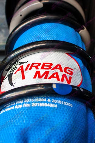

As mentioned earlier, in MB Speak:-) a picture below now of the socks/coil protectors from Google images although can’t seem to find them for sale on Airbag Man’s site: http://www.nissanpatrol.com.au/forum...2018/05/76.jpg

ttps://www.ebay.com.au/itm/FIRESTONE-COIL-RITE-KEVLAR-SLEEVES-UPGRADE-ONLY-OPTION-FOR-SPECIFIC-KITS/161763958542?hash=item25a9e21f0e:g:gm0AAOSwDNdVpbQ m
