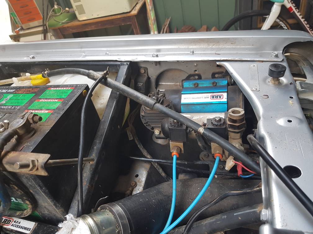

Probably not much help but this is where mine is mounted in the GQ which is where the air box is in a 3ltr. Good thing about the ARB ones is you can move them around a bit for different positions which helps. Still was a major PITA getting to the bolts on the bugger tho !
