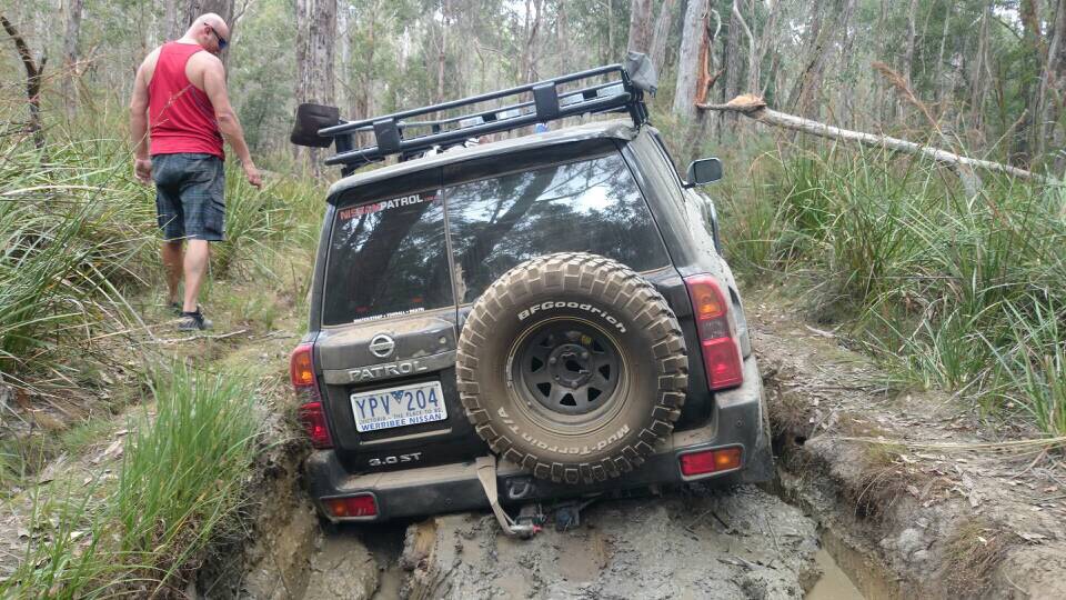

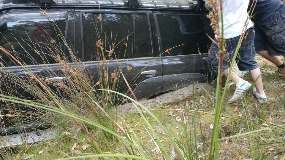

I got stuck in sticky mud and was winching almost flat out for ten to fifteen minutes.
Winch was outstanding.
3/4 way through someone said stop winching so I don't overheat the winch.
BA went in and said that it wasn't even warm yet so I kept going.
http://www.nissanpatrol.com.au/forum...2017/02/51.jpghttp://www.nissanpatrol.com.au/forum...2017/02/52.jpghttp://www.nissanpatrol.com.au/forum...2017/02/53.jpg
That's Gold Mego mate. Seriously thick underbelly sticky sh#t there, most winches would fry:-) !
