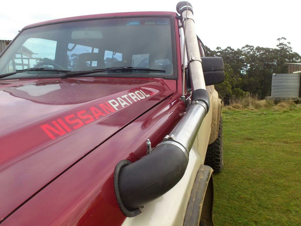

O.K..
A little embarrassing how clean and smooth it is.
That will be rectified soon.
Attachment 69579
Looking good, nothing wrong with having a nice clean rig.
>>>tappin from tassie
Oh God it still has that unique flexi pipe set up. How embarrassing!
>>>tappin from tassie
I didn't notice that until you pointed it out. All good, Bro, as it just shows a bit of ingenuity. Better than PVC down pipe.

That was from the previous owner... I fixed it as soon as I could!
http://www.nissanpatrol.com.au/forum...016/10/305.jpg
>>>tappin from tassie
Ohh! Nice shiny stainless.
