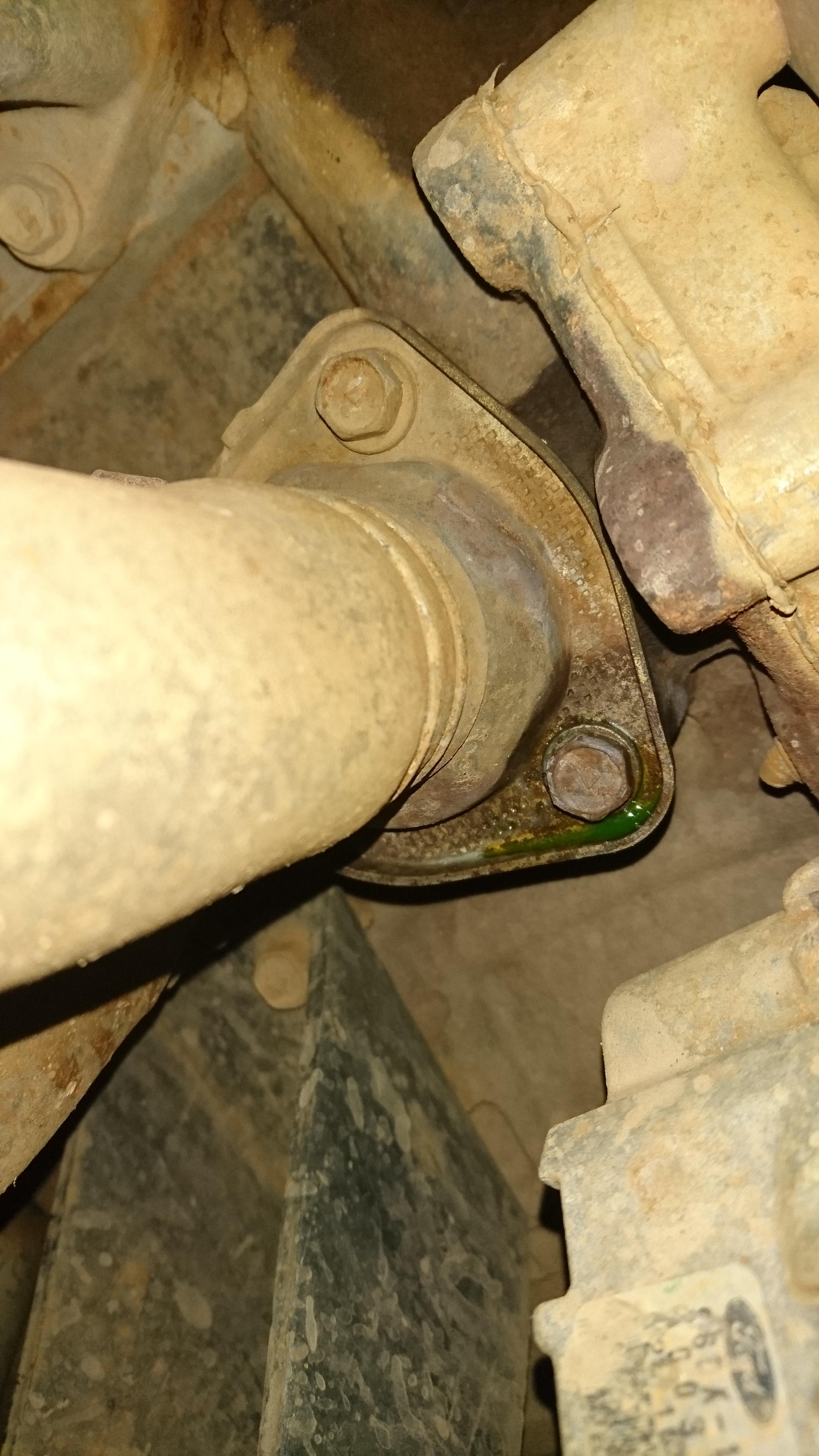

I'm thinking thermostat gasket is stuffed, and it's leaking through the bolt? Any other thoughts/opinions? GQ rb30 if it helps.

i think your right, i'd pull the gasket out get a new one and make sure the surfaces are clean then put it all back with a thin smear of silicone.
Yeah a smear of some RTV and you might as well replace the thermostat while your at it
Get rid of the OE clamp and buy a decent wormdrive clamp as well
Yeah, it's quite possible it's rusted through than gasket failure, or a combination of both.

Thanks guys. Heading away tomorrow night so no time to order a new housing and nobody stocks them locally. Hoping it's just the gasket, will use a cork gasket and a squirt of goo and hopefully she'll be all good.

+1 for housing corrosion. All too common
People think the coolant is OK because it is green, so they don't change it. (kind of like how most tend not to change brake fluid) Once it turns salt it allows electrolytic corrosion to occur within the cooling system.
First bits to go seem to be steel components like welch plugs, steel coolant pipes and yes - steel thermostat housings. Next is the alloy parts that turn to crumbly chalk.

Hey guys, cheers for the replies. Ended up being the gasket, the housing was in surprisingly good condition. Cleaning the surfaces up took the longest, razor blade and some sandpaper and a bit of elbow grease got them nice though. Replaced the thermostat whilst I was there. Took a while to bleed as it always does, but made it to Lake Tyers and back with no issues. Took twice as long as it should have as I put it back together but then realized I had both the new and old thermostats sitting on top of the radiator. Oops.
