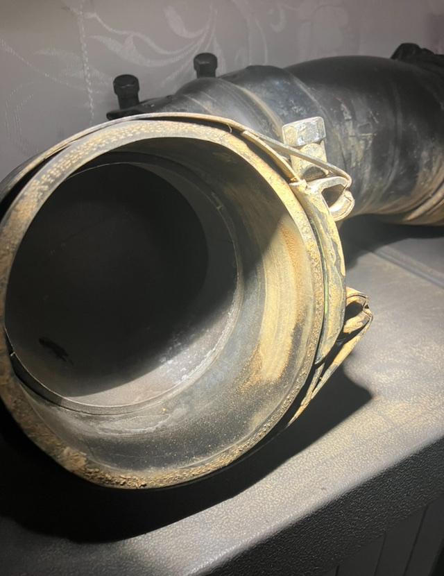

Was the only one I could find here tonight to Genuinely Commend UFI (United Fuel Injection- WA) on their professionalism personally experienced of late [emoji106][emoji106]
Long story short, bought a UFI beautiful complete TD42 kit: 11mm pump/deliberate choice of high mount manifold /18g turbo to complete my Tassie $1,000 & $10,000 tracks bucket lists [emoji3590][emoji3590]
Working with their Tech-Team Legends as to possibly how some silt may have snuck inside their fresh turbo with my best OCD submarine thought Nuffy efforts [emoji51]
https://www.nissanpatrol.com.au/foru...024/04/142.jpg
It’s looking very much like my own choice found back at home tonight upon further inspection of clamp choice (buckle) between airbox and turbo [emoji51]
https://youtu.be/gGwcH_vk0fE?feature=shared
@MB, have a look at these clamps as an alternative. The unit you used is heavy duty for sure, the link below has a distinct difference in that it has a spring effect that compensates for the compression of the rubber over time, so as the rubber get permanent set after being compressed with many cycles of heat and cold and the constant pressure, it will lose its elasticity and become just like a hard gasket. Maybe this is whats happened? These clamps have the spring tension around the outer and keep applying pressure regardless of the diameter changes. Might be worth a try? The only thing I dont like is the utililux style worm drive screw as these have been a weakness for my applications, but they have a recommended tightening torque so they should perform.

I’m leaning towards it being good old nuffy me again over tightening these heavy duty Norma’s against the slightly thinner material airbox 4” outlet [emoji51]
Did I mention above that UFI have Impeccable Legendary after sales service currently experiencing [emoji736][emoji3590][emoji106][emoji106]
But at the end, did it compromised your turbo?
Yes, I do believe my Brazilian Brother [emoji736][emoji736][emoji3590][emoji3590]
