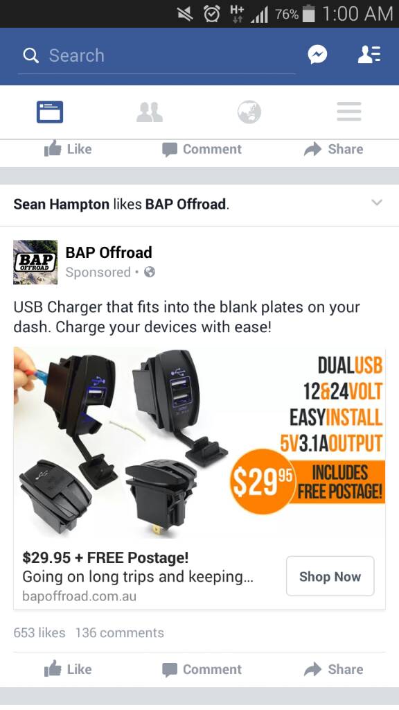

Well here ya go another option that I have just come across on fb..
It seems both ports on this one are 3A.. which is a bonus..
http://www.nissanpatrol.com.au/forum...015/10/427.jpg
I purchased and installed one of these a couple of months ago. They look great and work great - except that I thought that they were also an on/off switch so you could use the rocker to switch the USB charger on and off. They are not and as I connect every accessory to the auxillary battery, I had to install a separate switch. Otherwise the USB would be permanently on. Anyway, I don't like the idea of connecting the USB charger to the ignition switch because sometimes I want to charge things when the ignition is off.
I have mine live to the Aux battery with no problems ,
dont really have much room left for any on/off switches
