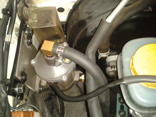

I Used a Carter 4600HP Fuel pump which is only 6-8psi of MAX pressure

I made a bracket for the fuel pump which i mounted on the exhaust hanger bracket behind the rear wheel, i then covered the pump with some rubber just too stop anything hitting it from the tyre

Once this was done i used some 90 degree fittings for the fuel hose. The factory fuel hose from the tank is accessed under the carpet in the cargo area of a wagon. I dont have a photo but its a big metal plate, 4 bolts holding the cover plate down about 30cm inwards of the very back. If you have drawers in the back of your patrol then they will have too come out unfortunately. I removed the factory hose from the tank too the metal line and re-routed it though the pump. This is a good excuse to replace all the factory old fuel hoses.
