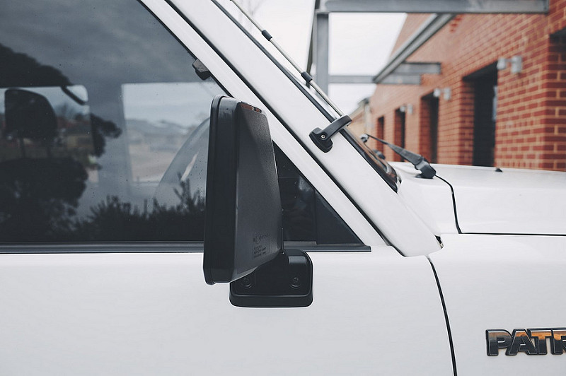

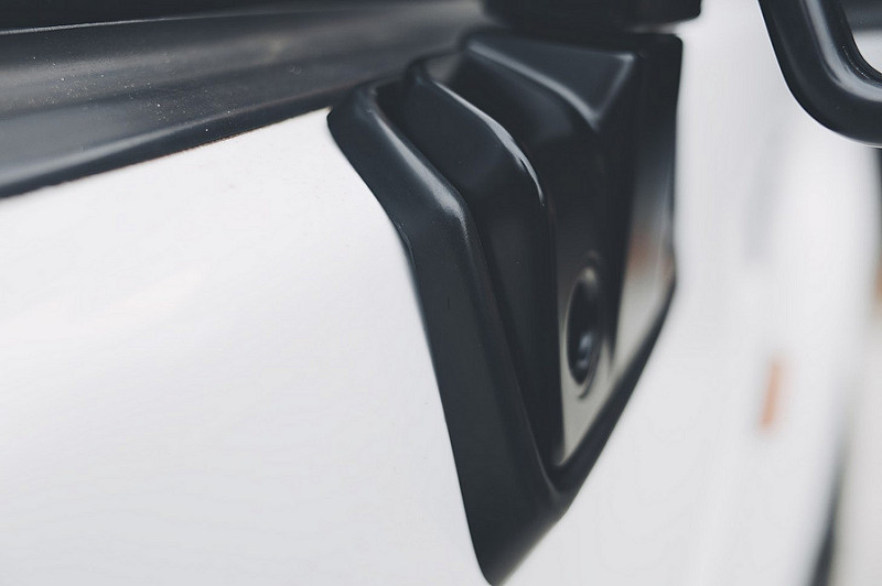

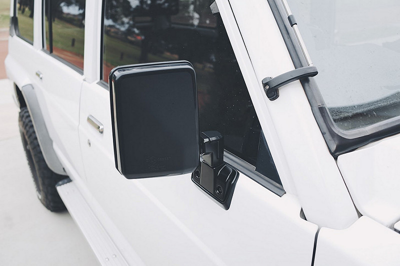

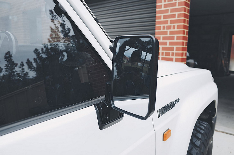

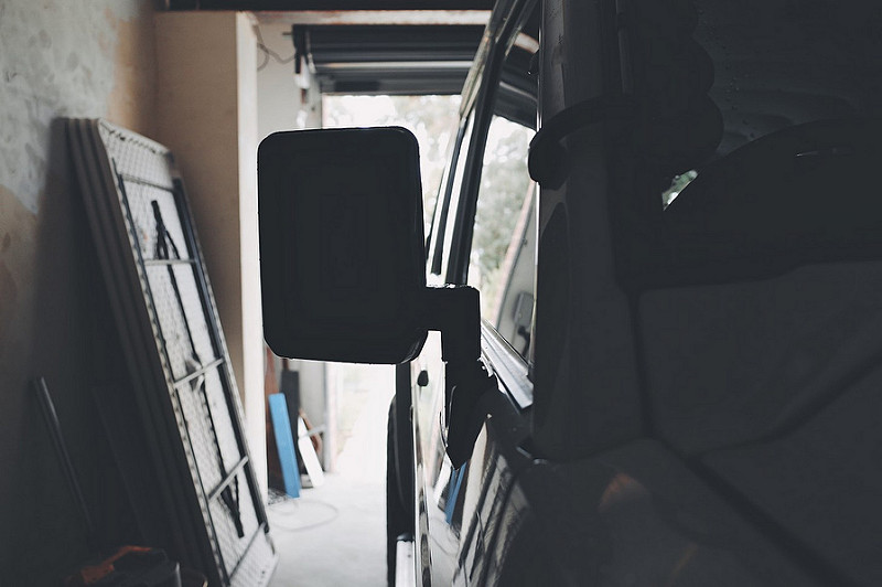

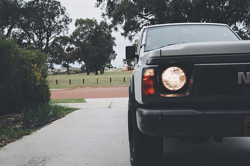

10/10 - The fit is extremely close, see 2nd image. Note, no modifications are required at all. The view compared to standard is improved 100x over. In my opinion these also look really good/standard on a GQ.

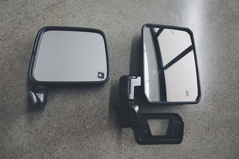

New vs Existing
http://www.nissanpatrol.com.au/forum...2015/03/20.jpg
The fit
http://www.nissanpatrol.com.au/forum...2015/03/21.jpg
http://www.nissanpatrol.com.au/forum...2015/03/22.jpg
http://www.nissanpatrol.com.au/forum...2015/03/23.jpg
http://www.nissanpatrol.com.au/forum...2015/03/24.jpg
http://www.nissanpatrol.com.au/forum...2015/03/25.jpg
http://www.nissanpatrol.com.au/forum...2015/03/26.jpg

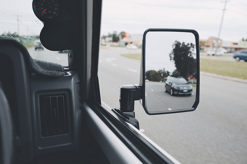

The View
http://www.nissanpatrol.com.au/forum...2015/03/27.jpg
