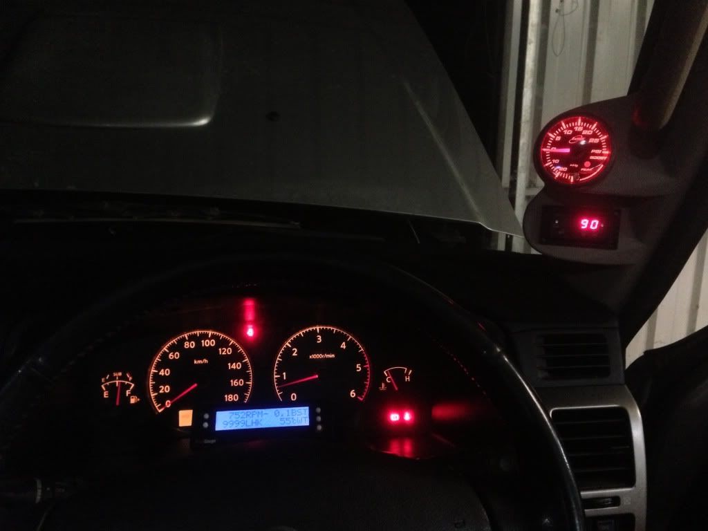

egt controller and boost gauge in pillar pod

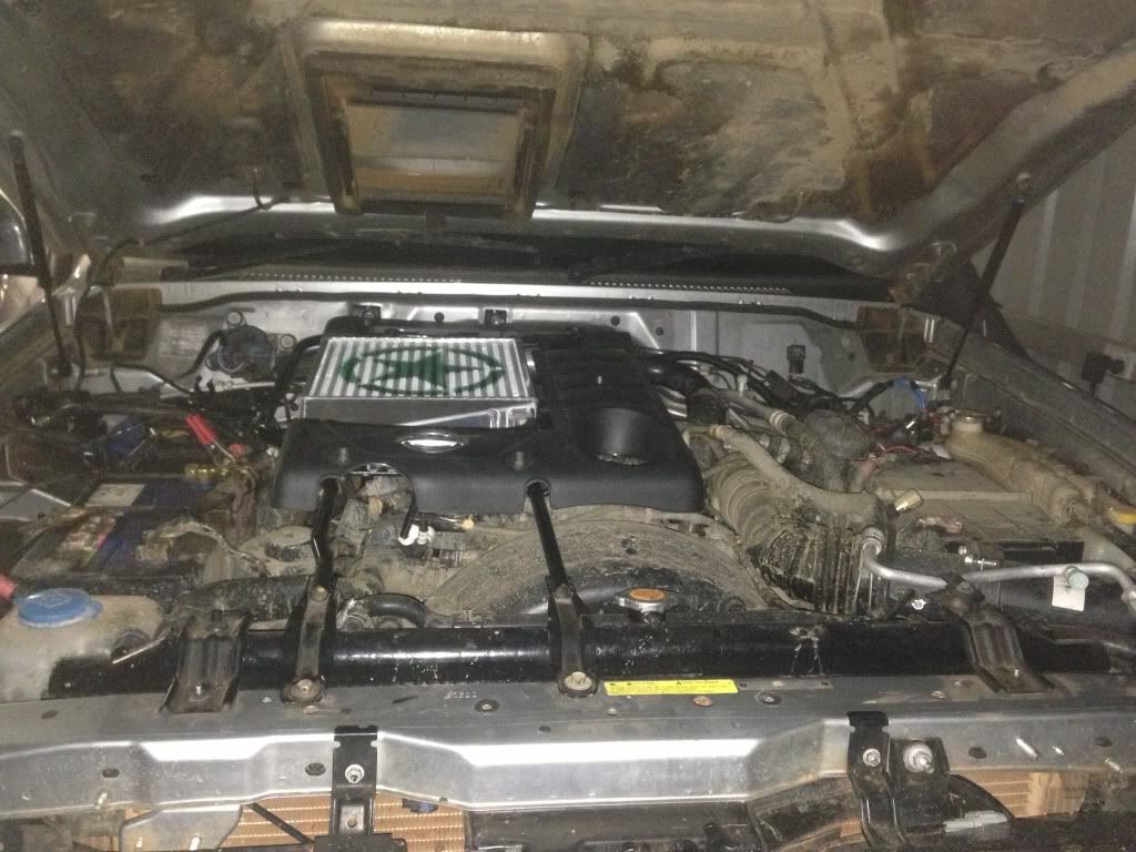

cross country intercooler with electric fan on 50c switch

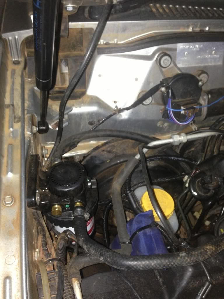

Fuel manager pre 30micron filter with water bowl

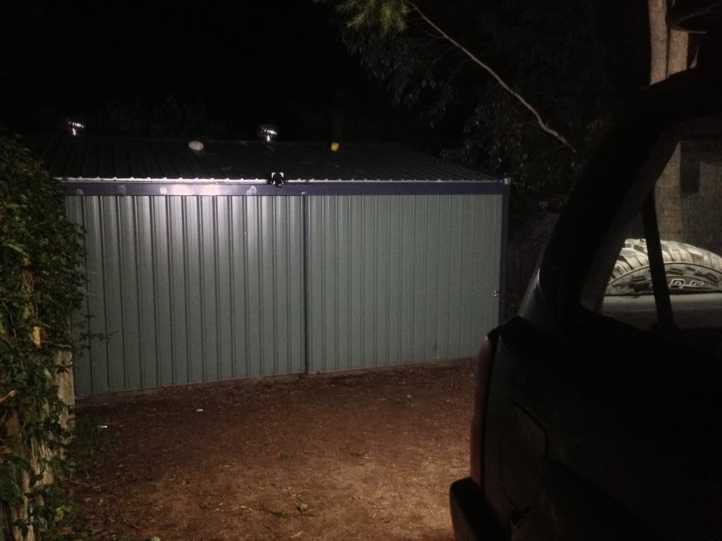

Rear LED work lights

Egt and boost
http://i785.photobucket.com/albums/y...697D819631.jpg
Cross country:
http://i785.photobucket.com/albums/y...69857EB47C.jpg
Fuel manager:
http://i785.photobucket.com/albums/y...698AC5F5E9.jpg
LED lights:
http://i785.photobucket.com/albums/y...69901075CE.jpg
