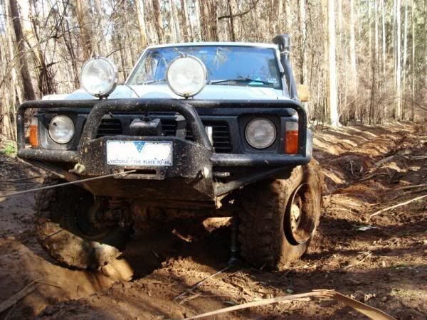

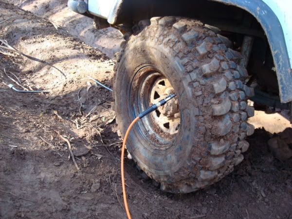

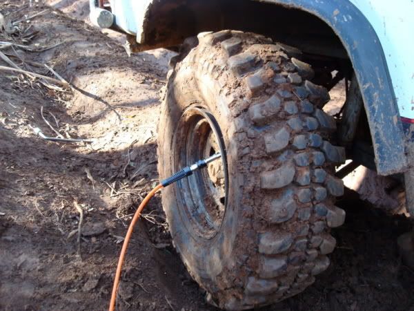

Thats a good point Darren BUT i don't need at high lift ATM lol but if i was on uneven ground i would improvise for the front like use the bottle jack to life the diff housing as high as i could then find something around me to wedge under the lower control arm and do as you said DIG! But each scenario is deferent same as every car so its hard to answer your question correctly.
Edit: just remembered that i had to try and inflate a flat tyre to raise a car chocked the suspension control arm to keep the ground clearance then let the air out of the spare and punctured tyre and re inflated the spare when it was on but like i said every scenario is defferent yeh!!
