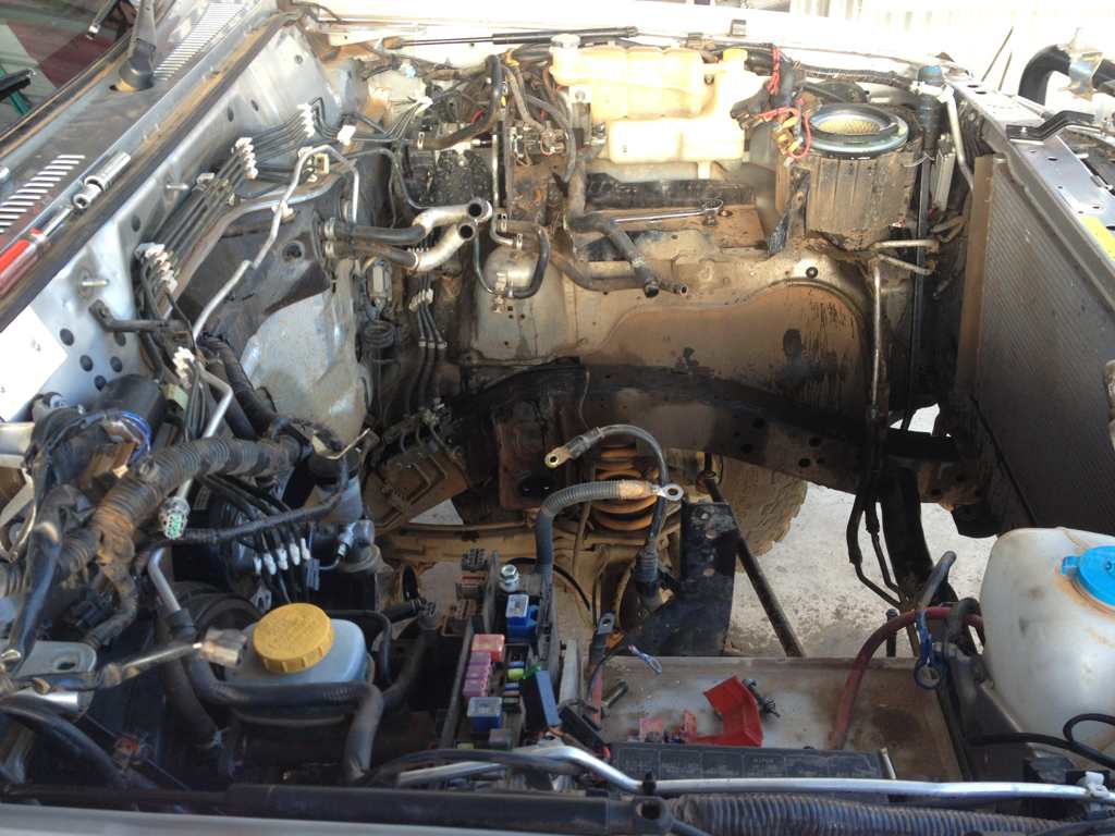

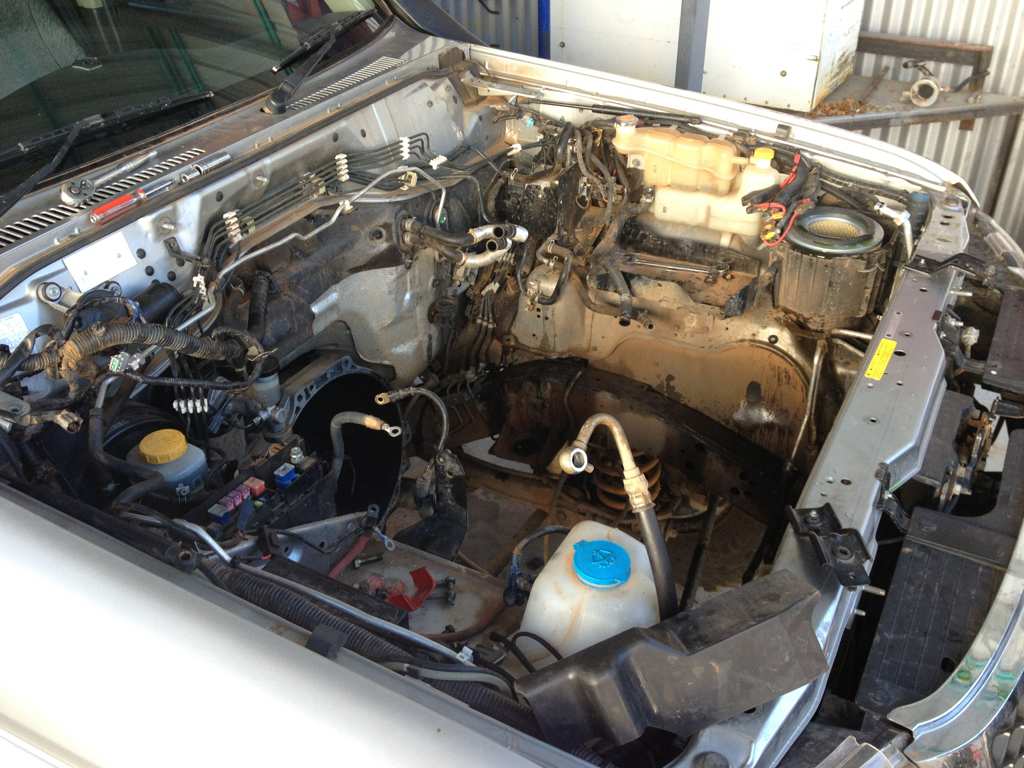

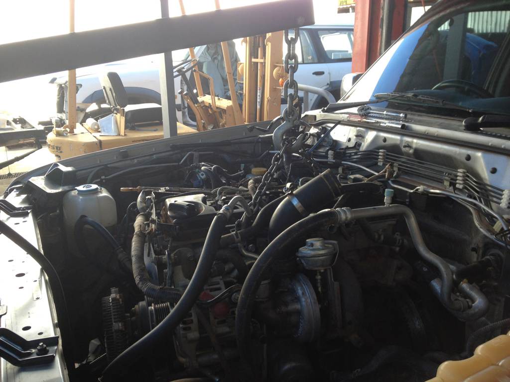

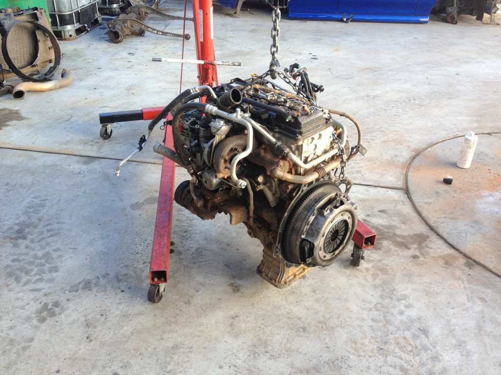

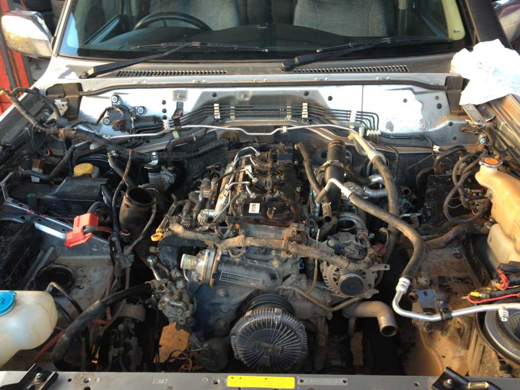

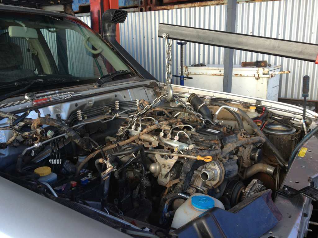

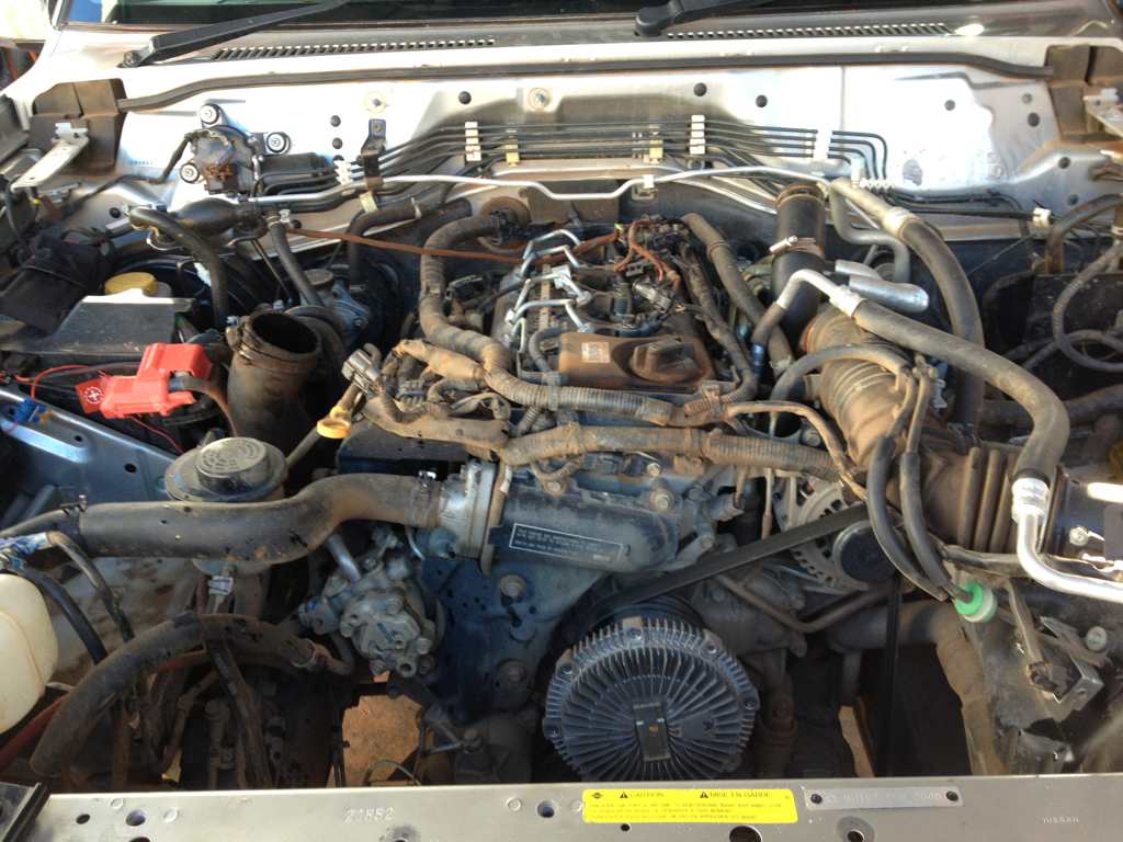

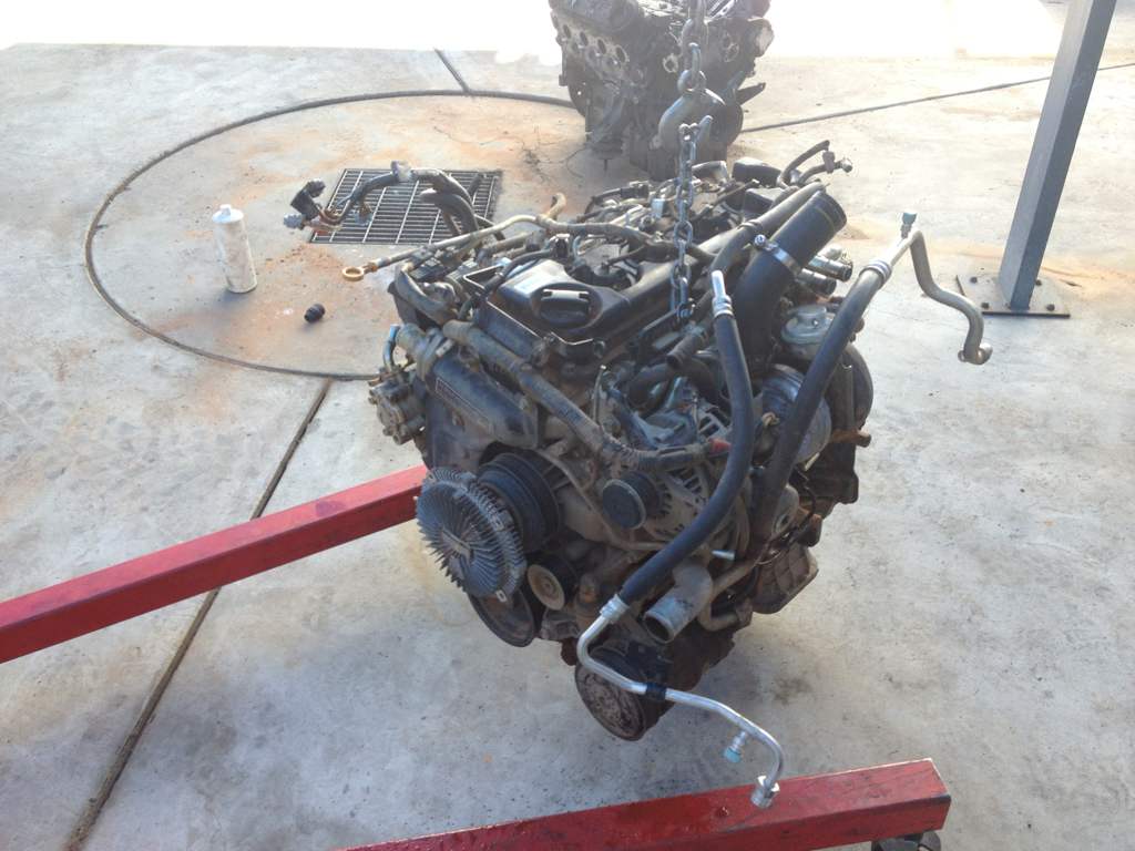

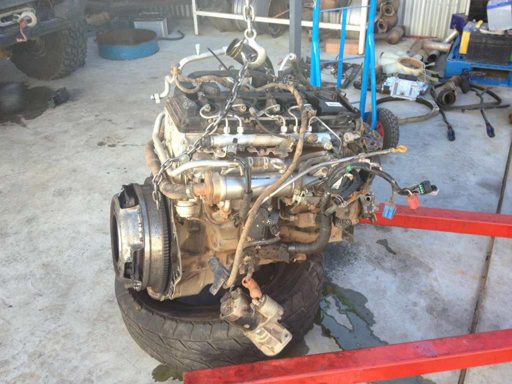

With the motor out, I turned to stripping out the harness computer and accelerator pedal.
As I hadn't sourced a replacement motor, time was taken to tidy up loose ends and rebadge.

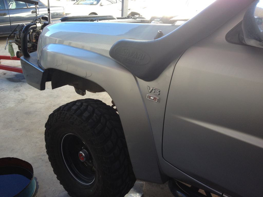

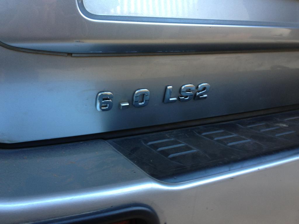

At a second glance I wasn't impressed with the rear door badging and decided to replace it.
http://www.nissanpatrol.com.au/forum...2012/08/49.jpg

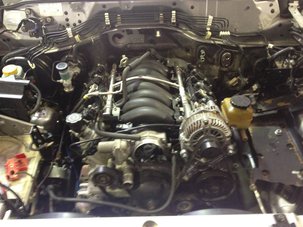

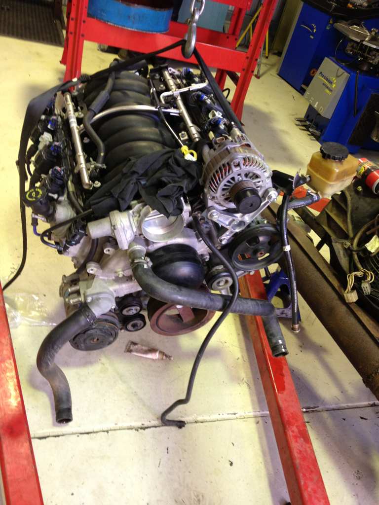

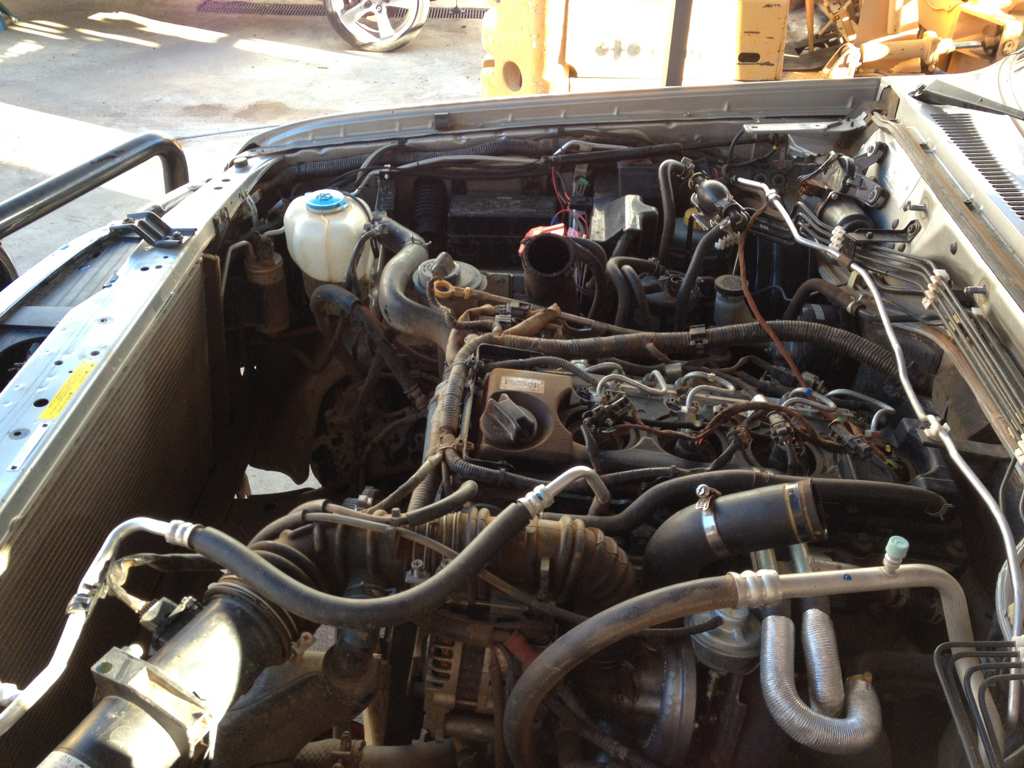

Once a motor had been sourced the harnesses from both engines where sent to the east coast to be mated, meanwhile the sump was replaced and the alternator moved to its new location
http://www.nissanpatrol.com.au/forum...2012/08/50.jpg
http://www.nissanpatrol.com.au/forum...2012/08/51.jpg
During this time the main tank was dropped and modified to allow a GQ petrol fuel pump and GU 4.8 fuel sender.

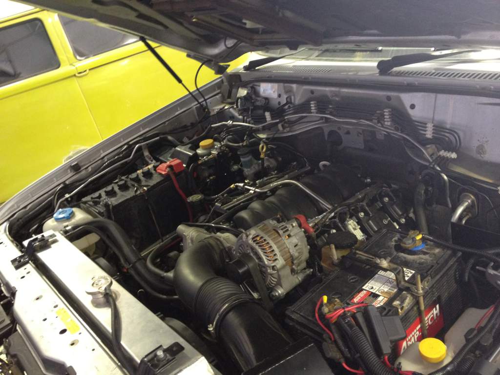

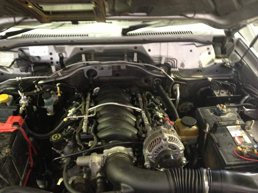

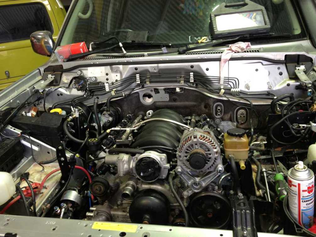

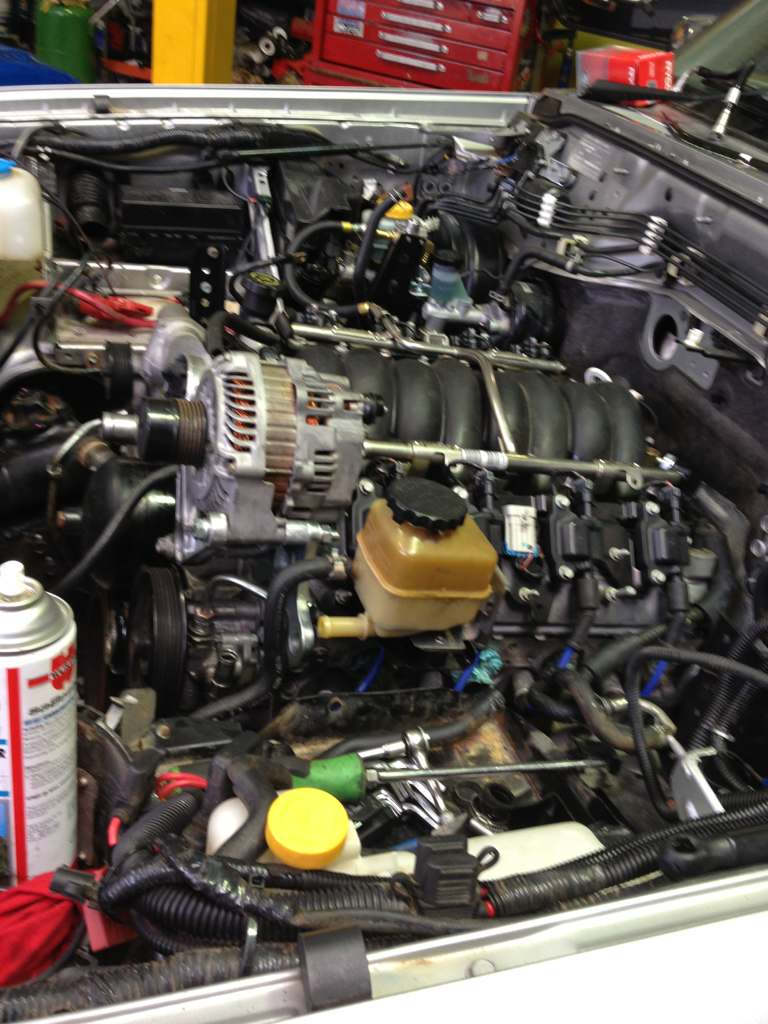

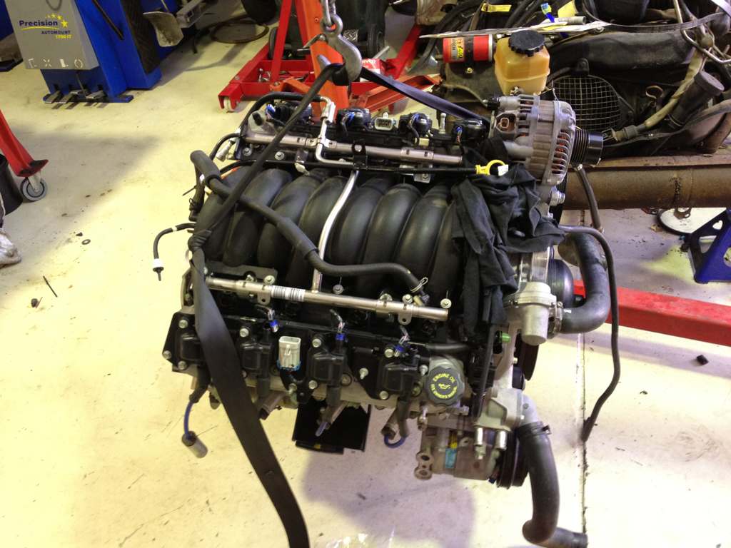

With parts now flowing in the exceedy clutch and marks adapters bell housing kit where fitted and the engine lowered into position, due to an ls1 and cruiser engine mount no modifications were required to the chassis.
http://www.nissanpatrol.com.au/forum...2012/08/52.jpg
http://www.nissanpatrol.com.au/forum...2012/08/53.jpg
http://www.nissanpatrol.com.au/forum...2012/08/54.jpg

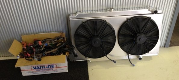

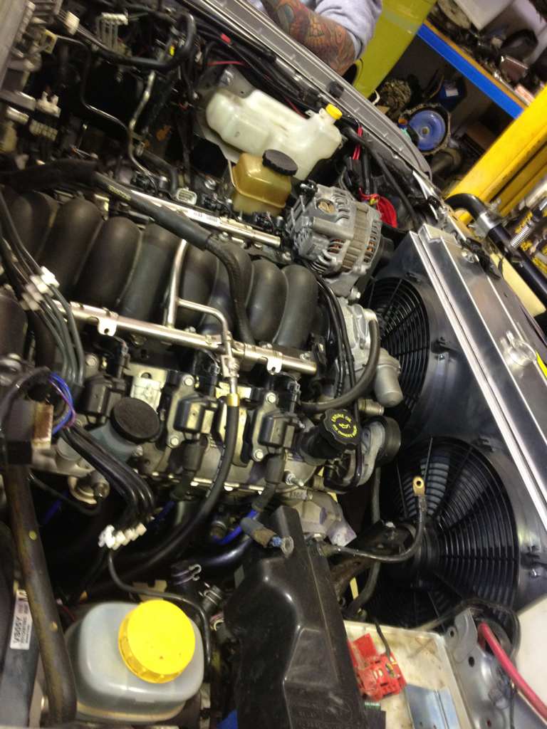

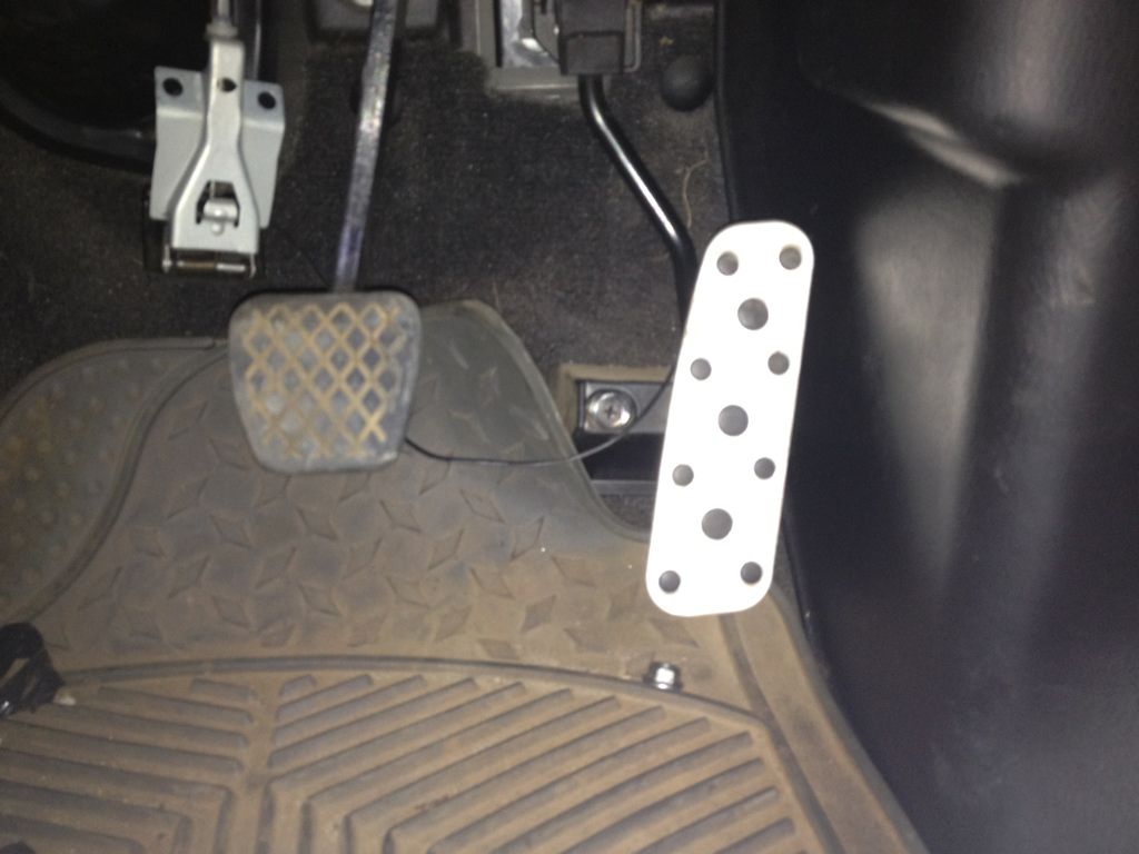

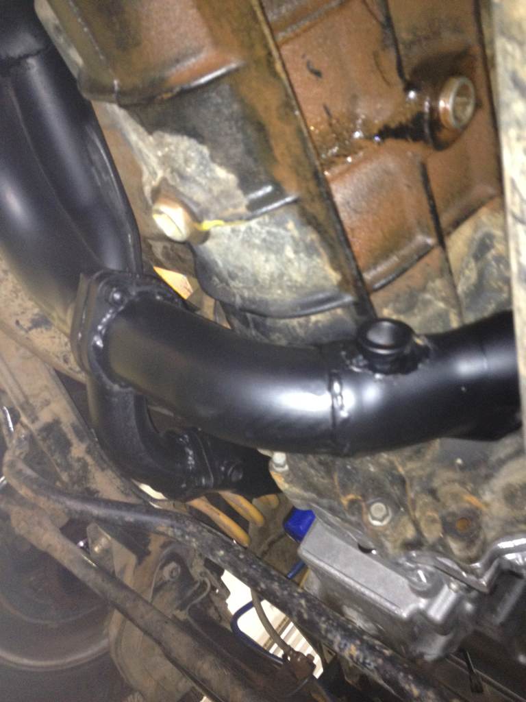

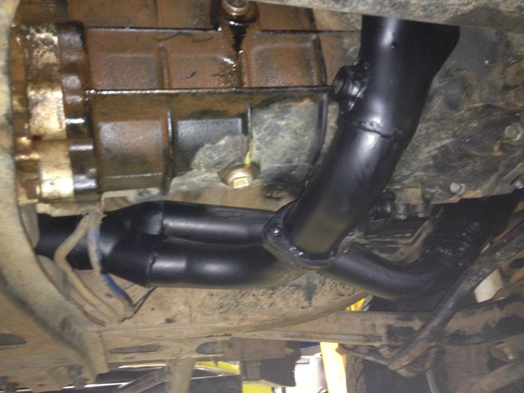

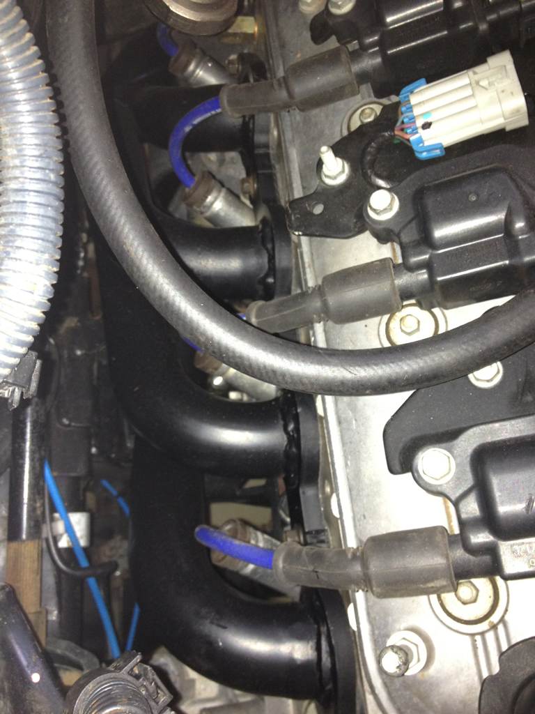

While waiting for the custom ally radiator and harness to return the accelerator from a commodore was bolted into place and custom extractors fabricated to plumb into the existing 3" system were completed.
Finally the harness and radiator arrived.
http://www.nissanpatrol.com.au/forum...2012/08/55.jpg

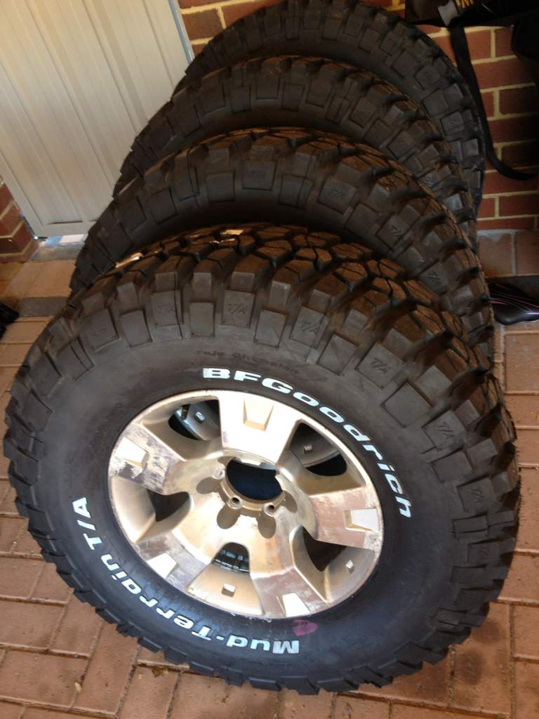

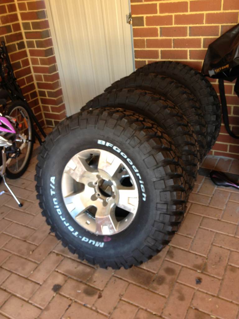

The radiator was then placed in an I went and sourced 10x factory 17" Nissan alloys to run ATs and 35" muddies. At this point I sold the 33/12.5r15 TTC claws to a good home.

KM2s were ordered today and the rims dropped off at Tyrepower, should be ready for pick up on mon

If you havent had them before you will love those tyres for what they are. They are a little on the expensive side but do most things well including wet bitumen.
When your finally rolling mate keep an eye on your system. Danny (Dung Beetle) from Your 4x4 did an LS2 into his 80 and a PWR radiator and twin thermo setup and had ongoing issues with stray current and electrolysis. I think 0.8v or something was all it was but was enough to start eating things and was unmanageable.
It cost his 6 months of chasing ghosts and gallons and gallons of vinegar trying to flush the block hoping his problem was in the LS2!
He ended up ripping out the awesome looking PWR cooler and going with a standard Copper 80 series cooler and his stray current disappeared.

I'm very interested to see how these tyres perform, my last two sets have been Mickey Ts (MTZ and Claws) but after good reports I decided to go back to BFG
Cheers mudrunner for the heads up.

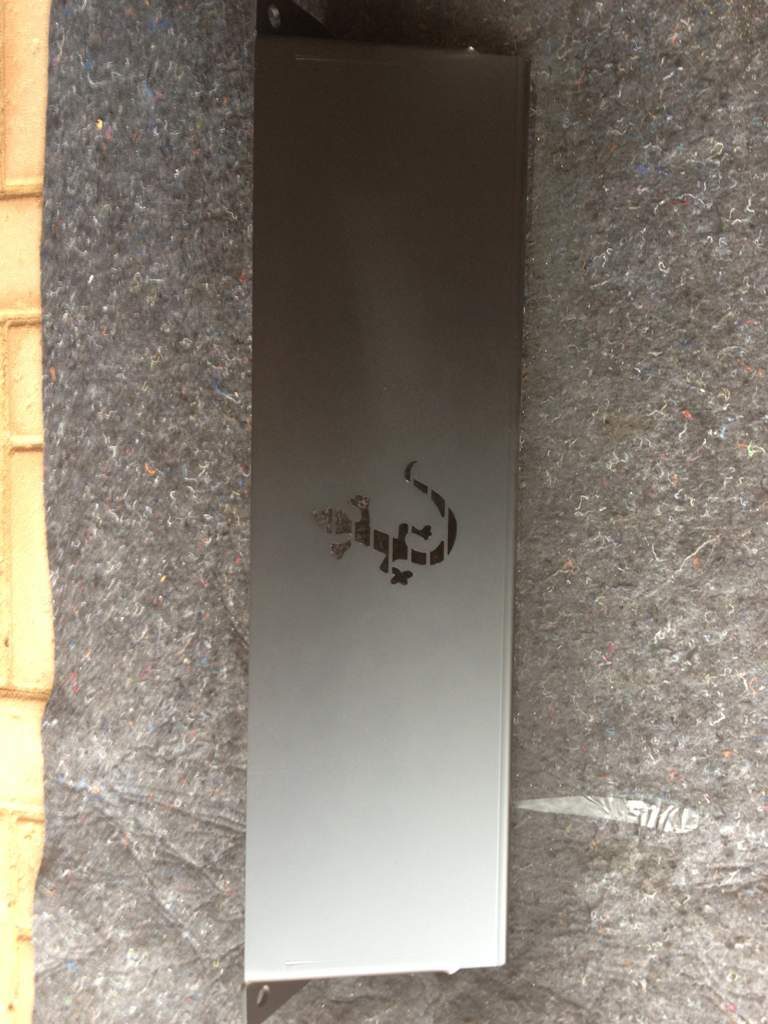

Forum Stickers
A big thanks to Mal, one of these will soon be bolted to the patrol

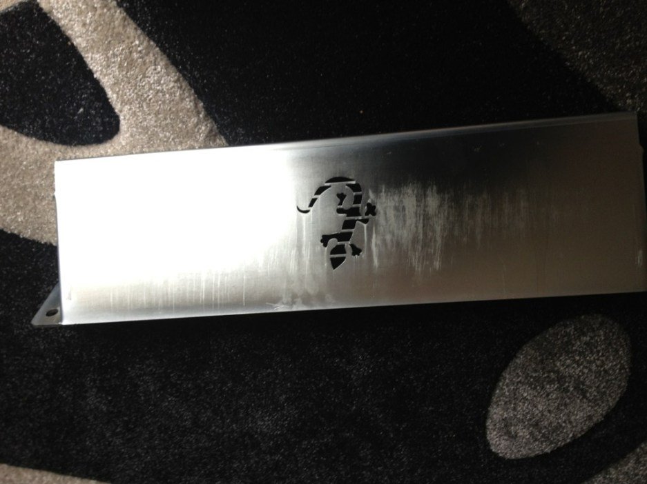

The weekend saw the patrol a few steps closer to completion.

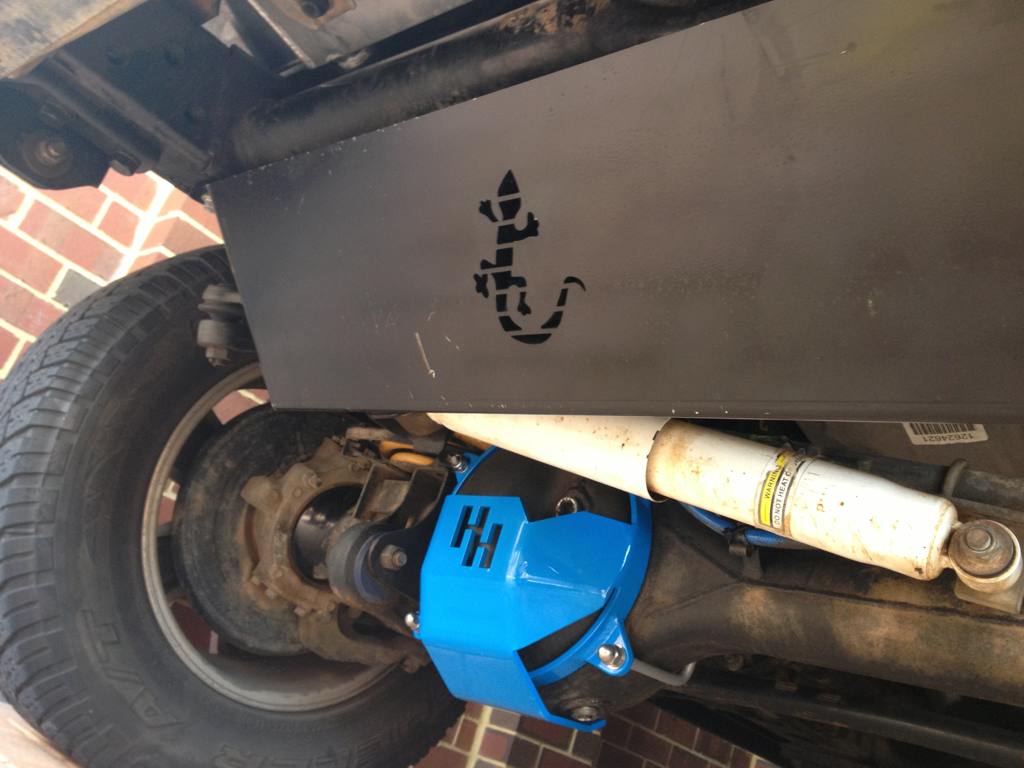

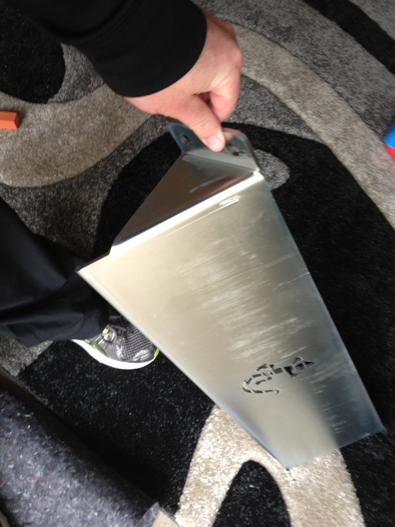

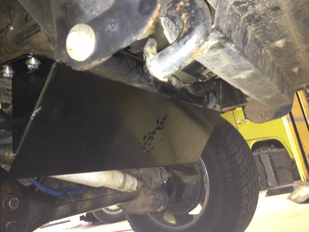

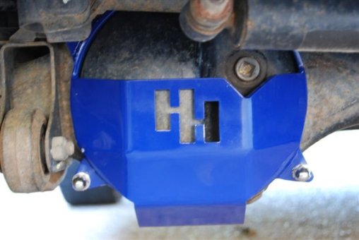

On Saturday I removed the lift and took off the light bar and rear work lights ready for the pits, I also fitted the front bash plate. http://www.nissanpatrol.com.au/forum.../2012/09/8.jpg

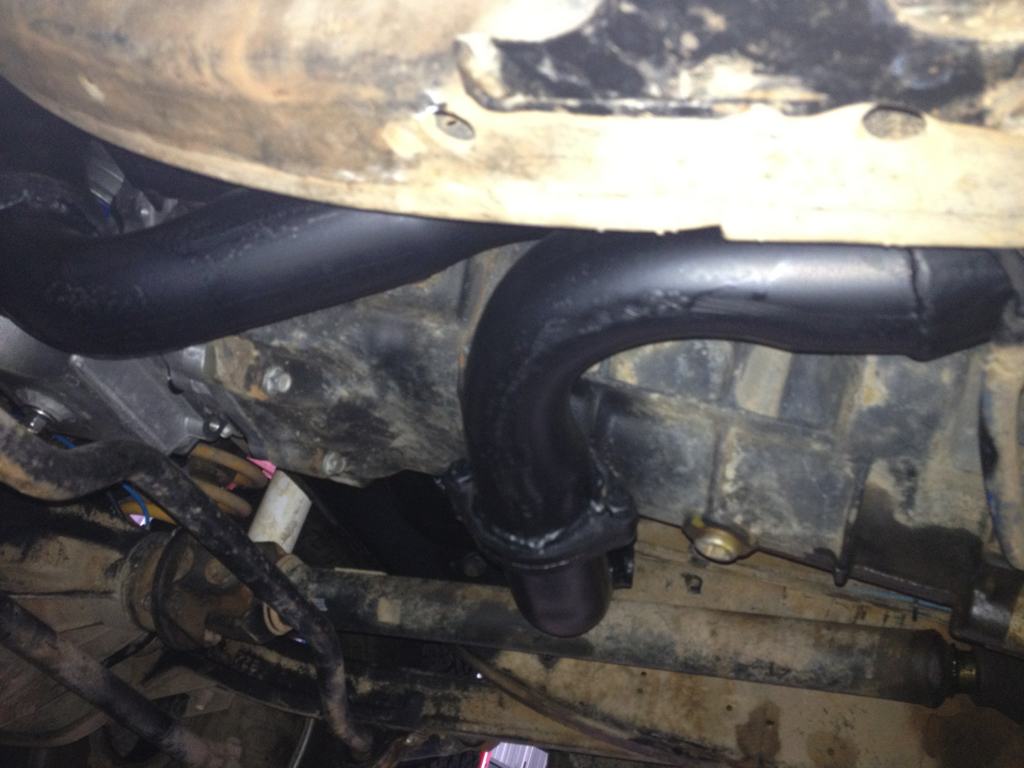

I also took some more pics of the exhaust, seeing as I didnt get any during fabrication.
http://www.nissanpatrol.com.au/forum.../2012/09/9.jpghttp://www.nissanpatrol.com.au/forum...2012/09/10.jpg

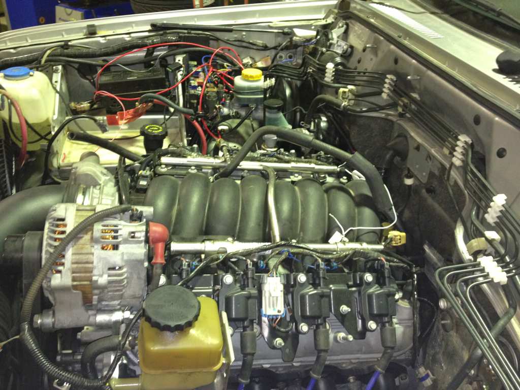

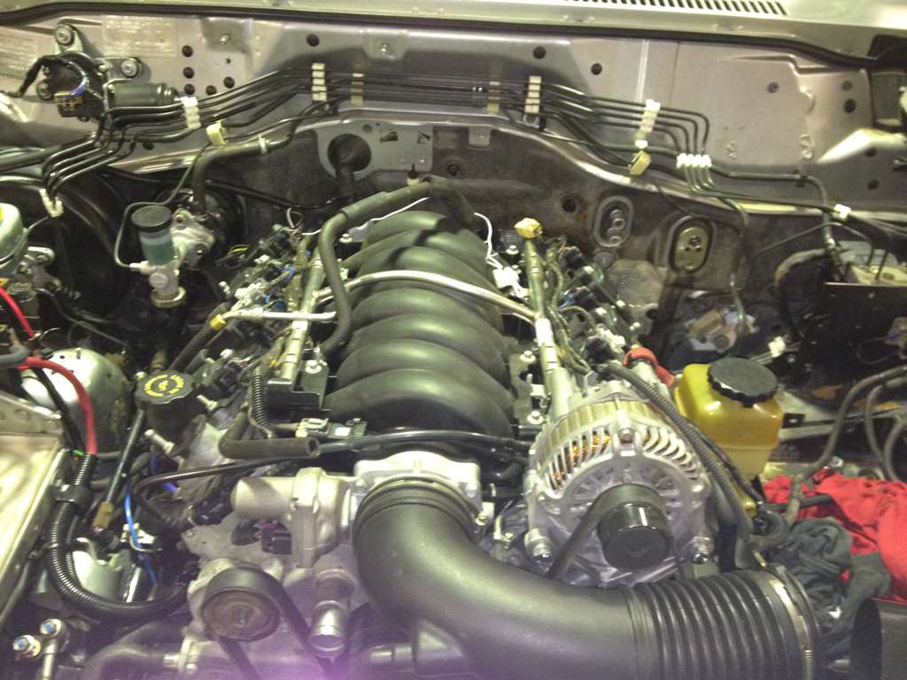

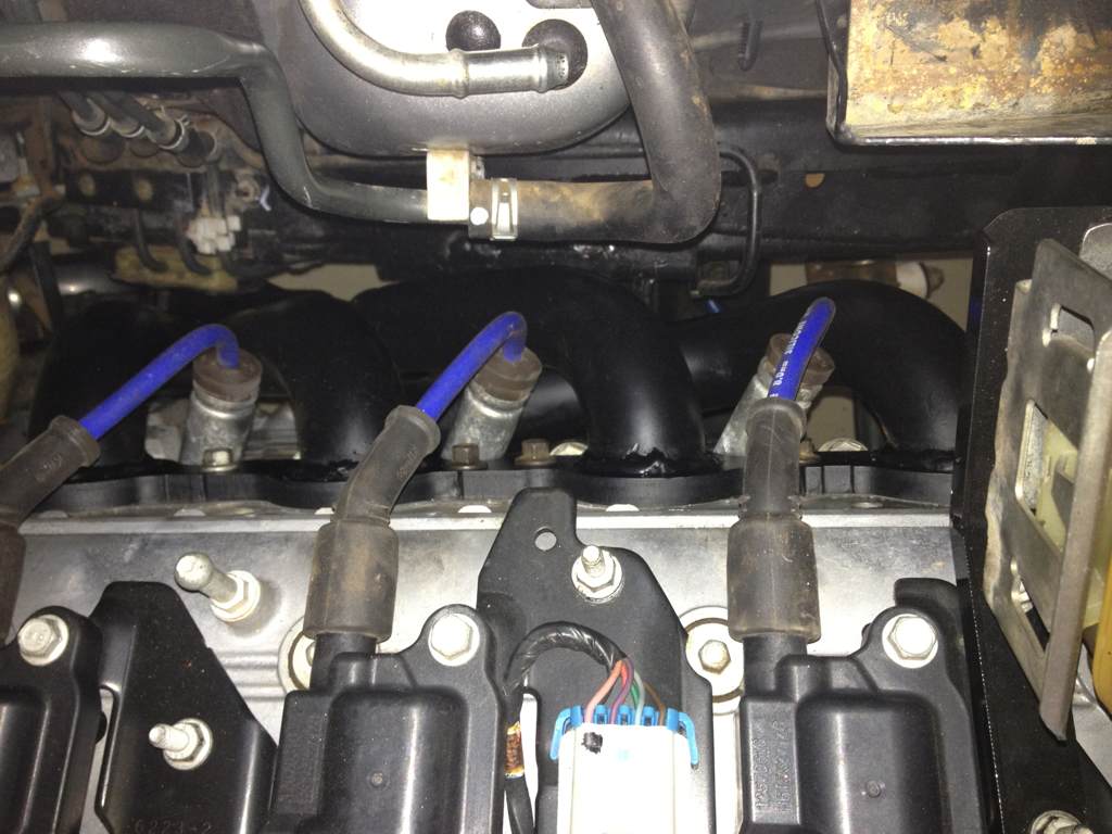

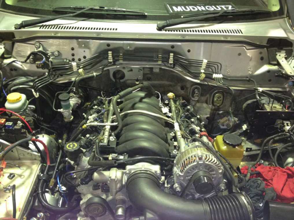

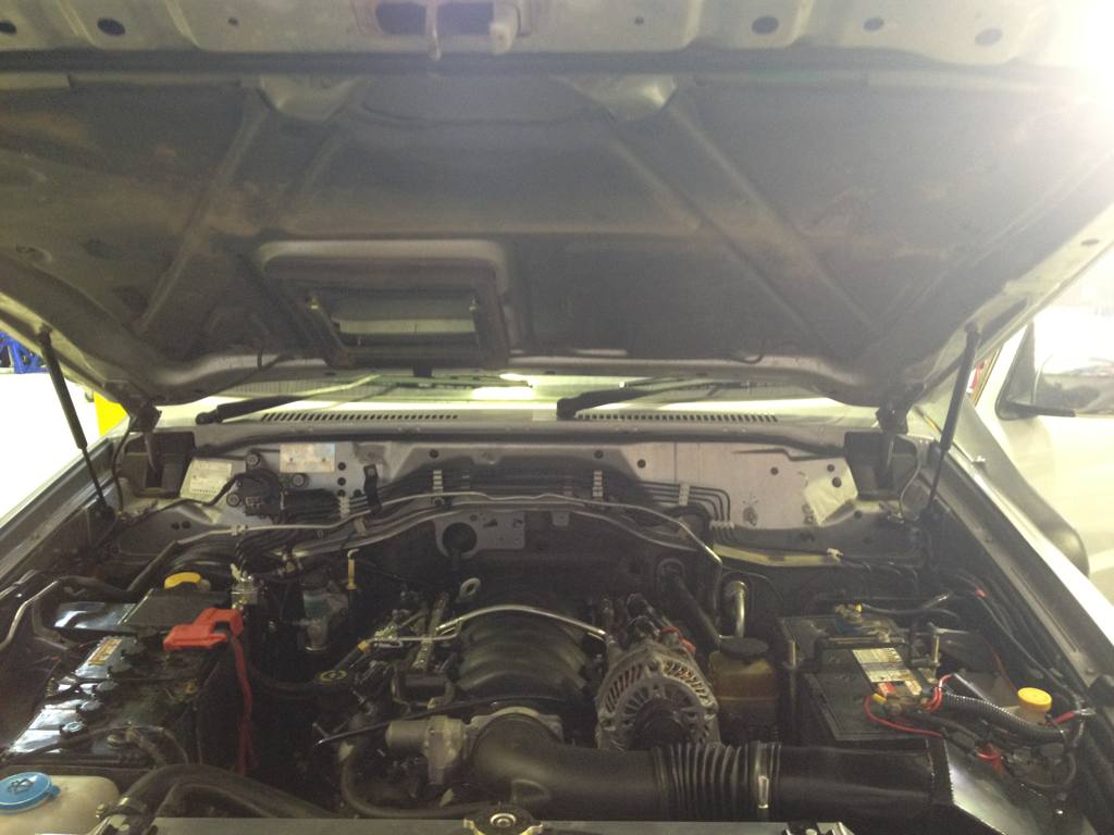

Sunday saw the fitting of the wiring harnesses and wiring up 99% of the car. The fuel tank was dropped and the new sender and pump fitted and the extra wiring ran. The computer was fitted after a custom mount was fabbed and the wiring for the trailer brakes was ran.
During the day the Heater hoses, and intake mountings were test fitted.
http://www.nissanpatrol.com.au/forum...2012/09/11.jpg
http://www.nissanpatrol.com.au/forum...2012/09/12.jpg
http://www.nissanpatrol.com.au/forum...2012/09/13.jpg
Last night was a magical night, the car was fired up for the first time, just waiting to get the security removed from the ECU so we can kick it over using the key lol

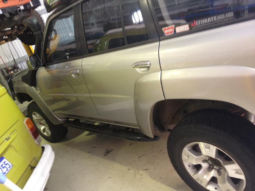

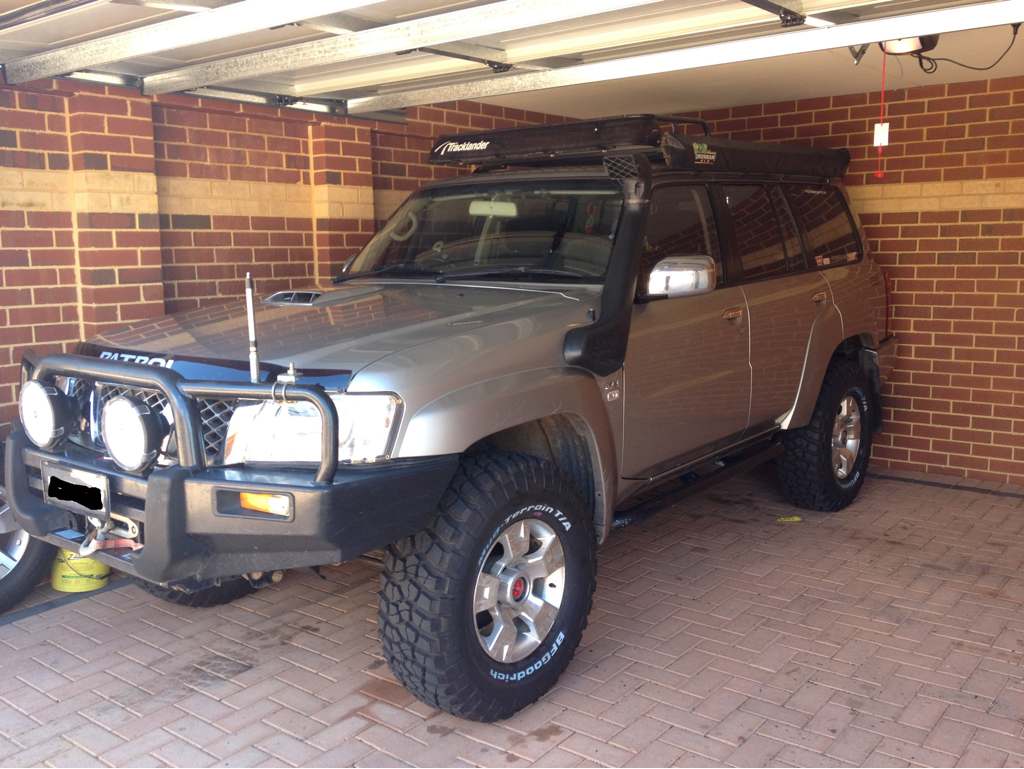

All good with the engineer today, installed the recaros today and put the 35's on although I have left the lift at 2" until it has gone over the pits
http://www.nissanpatrol.com.au/forum...2012/10/61.jpg
http://www.nissanpatrol.com.au/forum...2012/10/62.jpg
