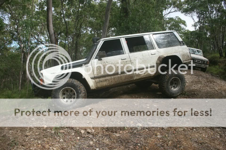

passed roady and shortly after that its first trip out.
http://i765.photobucket.com/albums/x...q/P1012430.jpg
really happy with its performance being my first 4by. Went everywhere i pointed it with no lift and 33's.
