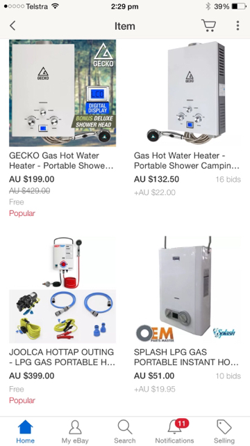

Interesting that you say that ET, I have been looking at a few different brands on EBay, I wasn't sure if the Joolca unit had a different internal to allow it to be rated for off-road solid mount to my camper?
There is a fair price difference! How confident are you that the other brands are basically the same?
http://www.nissanpatrol.com.au/forum...2016/07/11.png
@MudRunnerTD, The price difference is Joolca is made in Melbourne from parts in China, the others are made in China from parts in China :)
... as confident as I am that there are only about 1 in 5 Winch/Solar Reg/Car Fridge manufacturers as there are Brand resellers for example.
Take a look at the layout of the Gecko/Red Track/Instahot/Instatemp/Gleamhous/etc Heaters and the only difference is cosmetic.
The Instahot is the only one I have used but I would bet quids those are all the same manuf.
Haven't used or seen a Joolca and layout is different so may well be a different manuf hence my comment of 'two or three units'
Also keep in mind Daz that Geko one does not include pump and other fittings that the Joolca one does

Are you blokes saying the $51 one is as good as brand names on the market?
I'm a bit sick of my Coleman to be honest and if I can take one of these to Fraser I would have a happy wife!!!
Right. So let's make a list of who's bidding so we don't compete against each other lol..
I can wait.. have 12 months before we need it..
