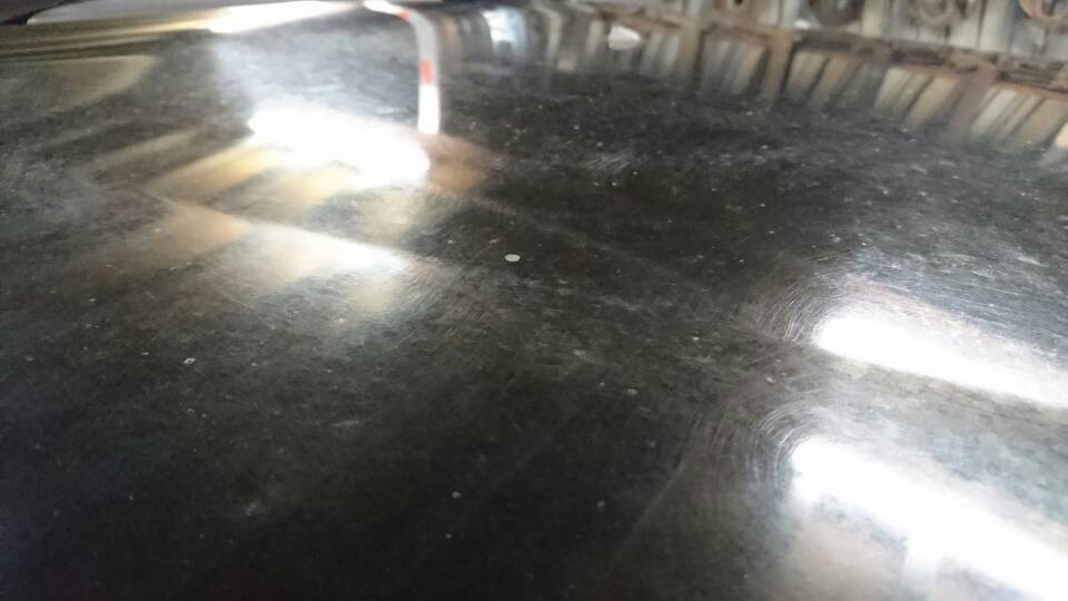

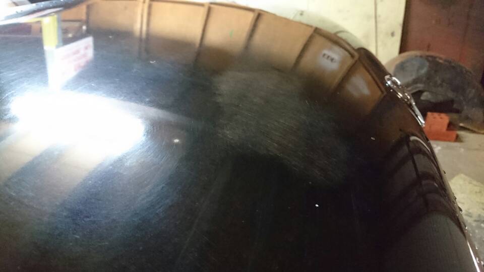

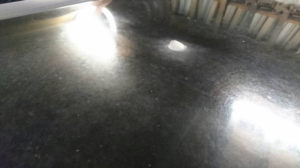

I polished and waxed my car yesterday and posted to what has made you happy today thread.
Here are the photos I posted
http://i868.photobucket.com/albums/a...psdqhn2xap.jpg
http://i868.photobucket.com/albums/a...psiumztydn.jpg
http://i868.photobucket.com/albums/a...pstzaz2eik.jpg
http://i868.photobucket.com/albums/a...pslvzhkvpm.jpg
http://i868.photobucket.com/albums/a...pson1p22i4.jpg
