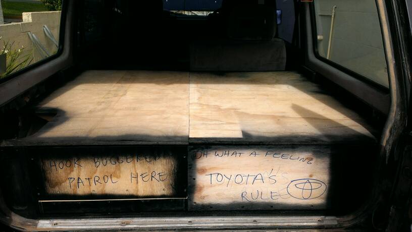

Next step is to frame the top in. This gives a bit extra strength, gives the draws something decent to lever against when out, and allows a lot more area to hold the top sheets down.
Attachment 28265
next up the draw runners. Instead of using expensive and heavy ball bearing runners, we've use a product called UHMW. its a very tough, hard wearing nylon which slides like butter on each other when loaded.. Each piece is 8mm wide x 3mm thick.
Attachment 28273
Attachment 28266

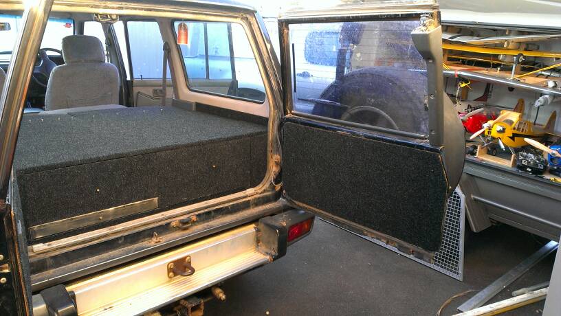

Next up a fitting and marking of the points to secure to the car. I've used the 2 seat belt points and 2 of the many tie down bolt holes in the rear..
Attachment 28267
5mm plate for the seat belt bolts, bolted to the box using counter sunk bolts from the inside, and a 5mm plate with counter sunk bolt for the rear points.
Attachment 28268
Attachment 28269
Attachment 28270
Next up are the wings. Once the box is secured in the center the winglets can be made to finish the face off. Quite simply a bit of off cut screwed on...
Attachment 28271
Attachment 28272
Still plenty of room to access the jack

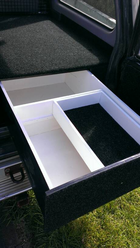

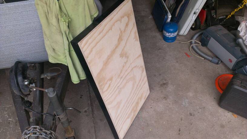

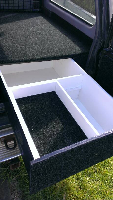

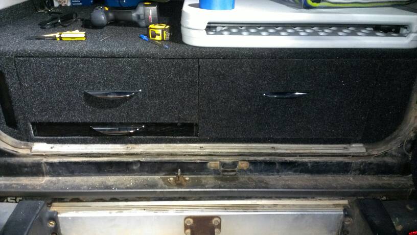

So there now painted..
Attachment 28276
Attachment 28274
Attachment 28275
http://www.nissanpatrol.com.au/forum...2013/04/90.jpg
http://www.nissanpatrol.com.au/forum...2013/04/91.jpg
(excuse the father in-laws swearing)

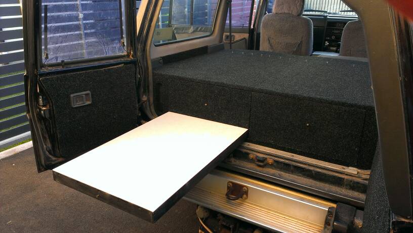

The white draw above is the pantry.. have painted it white inside and will be clear coating it to make messes easier to clean. And it feels cleaner being white..
The thin one is the pull out bench, this will have a sheet of laminex vinal (kitchen bench top stuff) glued to the top for food prep.
