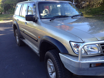

Relauching a build thread... BOB!
Yes, it's called BOB... My kids named it from the first three letters on the number plate (state issued).
I'll relaunch my build thread now that I've come to solving the coolant loss problem, namely a new engine is being installed next week so I'm hoping to be out in the bush a week later ;) A bit of a bugger when you have a cracked head and no mechanic is able to tell you that's the problem :(
The cars a 2003 GU III 4.8 ST (TB48DE) and will have a new motor (3 yr unlimited km warranty). Once I pick it up it will be back to the LPG mechanic for a tune to make sure it's all good. No turbo at this stage but it is an option I'll consider down the path.
