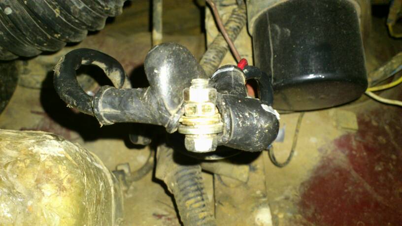

the instructions say to by-pass the balast resistor. I bypassed it and joined the wires but i didnt solder them. Could that be a problem?
I joined them like this. I thought that it would be as good as the original join onto the ballast resistor.
http://www.nissanpatrol.com.au/forum...2012/11/20.jpg
Sounds like a component breaking down as it heats up. Could be a faulty module.
