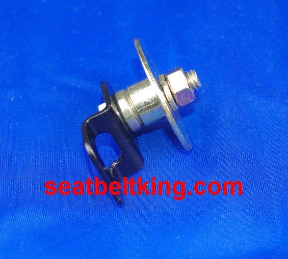

There are bolt holes on the floor just behind the second row seats for the child seats to go in the left or right hand side of the second row seats.
You just need to buy of these below and bolt it in.
http://www.nissanpatrol.com.au/forum...2012/08/31.jpg

I have just been out having another close look and found one threaded hole
Behind each side, but right next to the inner edge of wheel well.
And the bolt from my anchor kit fits the thread. So I am one step forward.
Only issue with this point is that it does not line up directly with the centre of the seat. It's a few inches to the outside of the vehicle. But that looks like my only option before have to go down the crab bar route.
