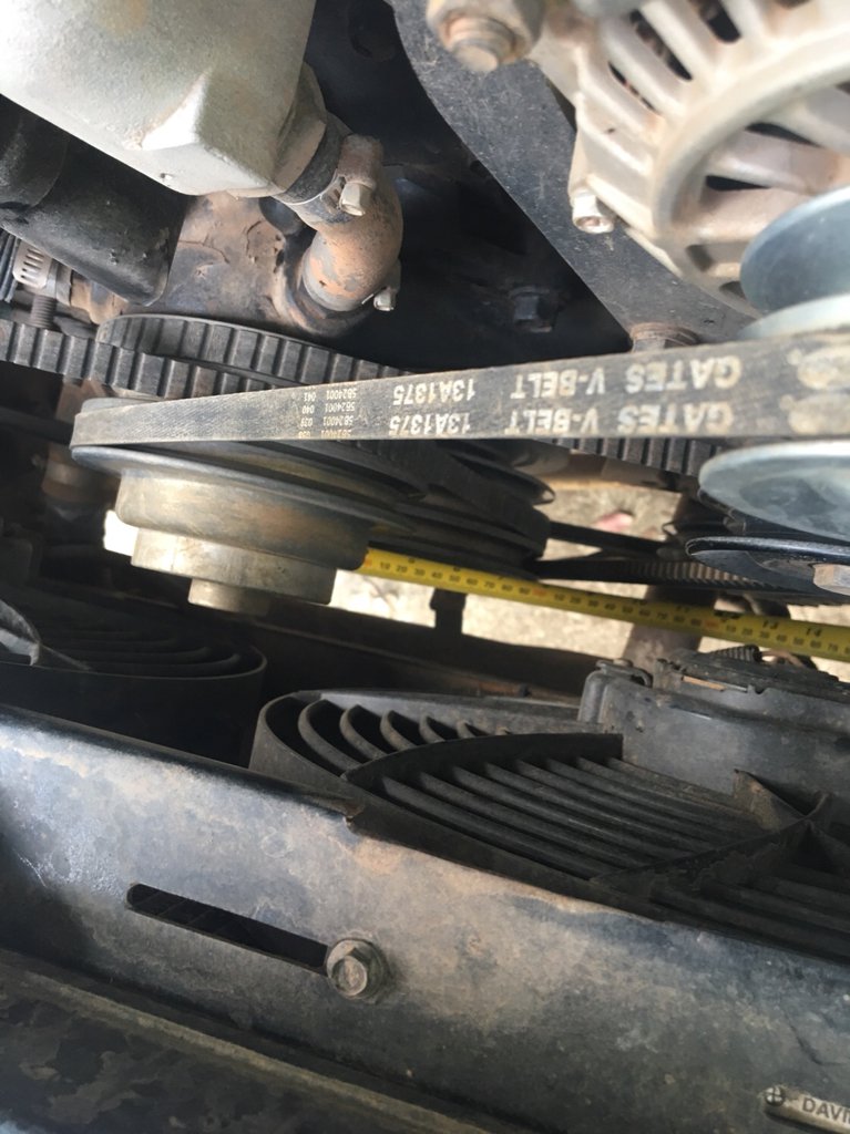

A poofteenth under 80mm OD checked here thanks mate. http://www.nissanpatrol.com.au/forum...018/01/143.jpg V belts obviously slightly smaller ID measurement.
Mine is 60mm at the flange, approx 55mm at the drive face as the flanges are approx 2mm high.
Sooo... FWIW... my ALT will be spinning much faster the yours.
Is your pulley the same dia pulley it was supplied with for a TD42 or did you reduce it for the 6.5?
The other variable would be the dia of the crank pulley which is what determines belt speed but IMHO as there are other accessories all driven by the belt like A/C, P/S etc you would think the belt speed should be similar between 3 belt and serpy
Cheers mate, huge Alt pulley size difference there :-(
Yep, it is the same pulley supplied and near identical size to the failed Mitsubishi that was already on there. Going to go check the crank pulley size now :-) @PeeBee mate, your NA Mitsubishi Alt from factory failed pretty quick too maybe?
Ok, crank pulley OD on the 6.5NA V belt jobbie here is 195mm ish. So.... 195mm to 80mm at 1:1 drive = ? @ PeeBee please mate :-) ! http://www.nissanpatrol.com.au/forum...018/01/145.jpg
