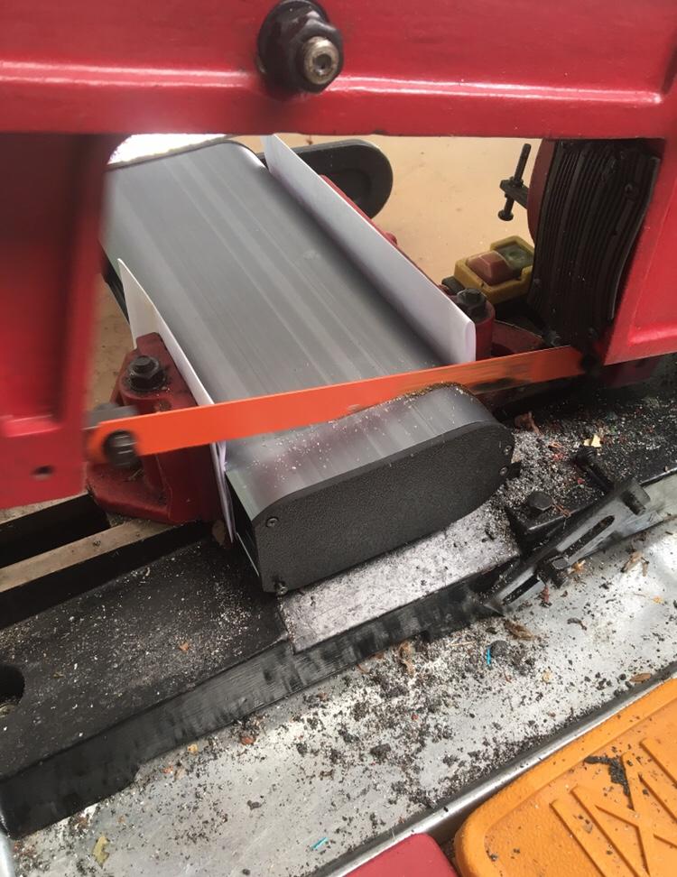

Sounds like you are making short work of it. Do you have any pics to share?

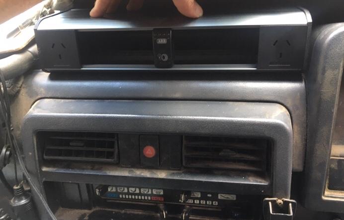

At the beginning of a GQ Grandpa Spec ute build/bought up to gnarlier tracks worthiness and currently scratching my head where best to lazy situate all rocker switches pilfered off the soon to be GU daily comfier ute tourer again[emoji120][emoji106]
Found this beaut aluminium extrusion originally family built for a 240v application and after a quick docking fits the old GQ flat dash perfectly[emoji106][emoji106]
http://www.nissanpatrol.com.au/forum...021/01/108.jpg
Carling switches off the GU will work well too by the dozen I believe/hope [emoji1696]
http://www.nissanpatrol.com.au/forum...021/01/109.jpg
Before I start on this next wacky adventure can anyone kindly please guide me as to whether they believe the summer time parked up windscreen heat might cause an issue on the switches possibly....hopefully not? [emoji120]
