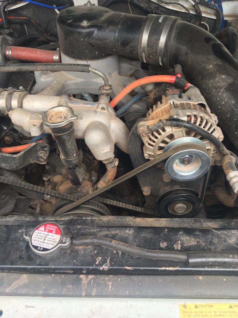

Qwik piks of the air install on mine.
Runs off the A/C pulley (obviously)
Only issue is that it is goddam hot down there under the A/C
Soooo... I'm thinking of sourcing cooler air somehow
Whereabouts ET on the turbo serpy beasts do BD position the alternator mate? Our NA’s have em on top but still friggin hot up here. http://www.nissanpatrol.com.au/forum...018/01/138.jpg Really do have to pull my finger out and get the new bonnet painted up and fit it to catch some fresh air :-(
