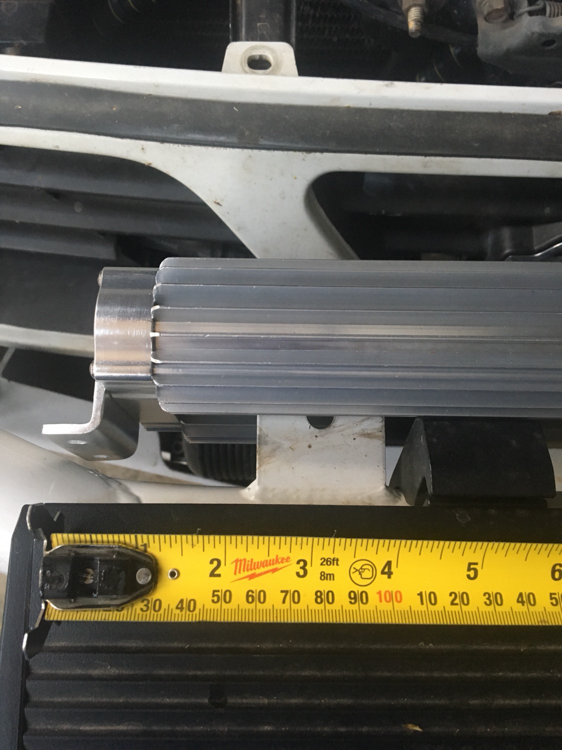

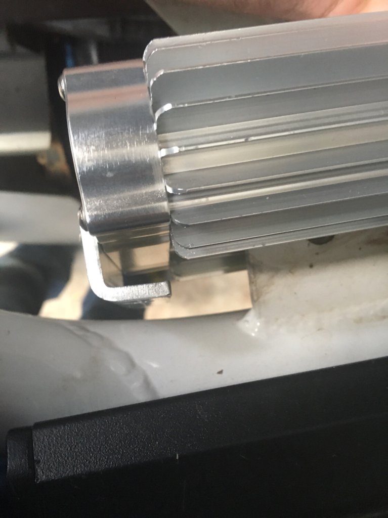

Cheers Phil, was playing around with that earlier and found using the existing bullbar tabs sets the cooler back too far and I can’t open the bonnet. It’s because the Millweld bar is set so far back for entry angle. These tabs aren’t being used so considering cutting them off to bring the cooler almost hard up against the ARB light bar brackets and on a 20 degree angle. http://www.nissanpatrol.com.au/forum...018/01/105.jpghttp://www.nissanpatrol.com.au/forum...018/01/106.jpg Do appreciate any and all ideas before I hack away and butcher it :-(

Can you reverse the feet and point them inwards, them mount the cooler horizontal instead of vertical? Or mount it horizontal and modify the angle foot - chop a corner off and re-drill on hole to make it fit neat with the back of the lightbar - which won't be there after you send it over to me!!!Attachment 74201

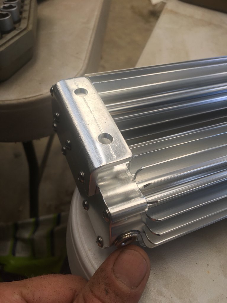

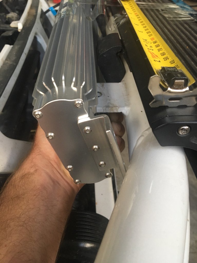

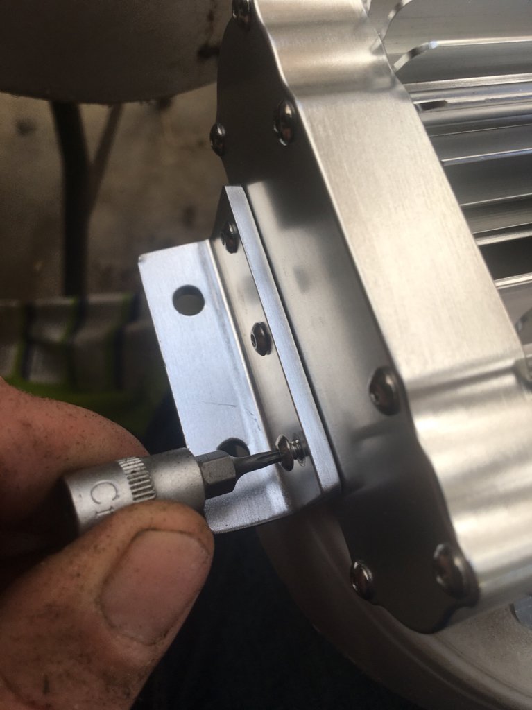

Just flipped the coolers brackets, (please do check yours Phill mine were only finger tight outa the box) http://www.nissanpatrol.com.au/forum...018/01/107.jpg Noticed there is a drain bung on them which is cool ! http://www.nissanpatrol.com.au/forum...018/01/108.jpg It really does seem to be screaming out for U bolt thingys or light bar clamps as the brackets are now back inside the welded line of the straight part of the bar. http://www.nissanpatrol.com.au/forum...018/01/109.jpg
You might have to insert the bolts first into the feet and mount the bracket os put the nut on top - looks heaps of room
Will it fit between bullbar and bonnet in any fashion when horizontal is perhaps the question and if so what are the advantages of vertical, horizontal or angled and can you make it work? -- Of course you CAN.
Just worried if I run it horizontally under the bar it will be blocking some airflow to the grill which I’ve always kept as clear as possible nowadays. Judging by the drain/bung on these they look meant to be mounted vertically so the bung is at lowest point.

You don't need the bung, what are you draining? Sit it up on top of a plate mounted off the bottom of the existing BB tab.Attachment 74202
