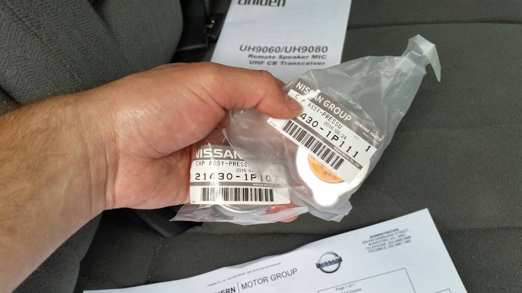

You haven't done something like knocked the caps on the overflow and released the seal just enough?
I am hoping it is something as simple as this. Bleed system again should solve it as well as some new caps while I'm at it... Will have a crack.
Even so, if I did... Where did the bit of coolant go. I understand the pressure cap on the header tank has two functions it is a pressure cap but it also allows the radiator to suck back the expanded coolant back as it cools to maintain a filled up airless system.
I'm always a bit cautious on bleeding this system.

Picked up some caps before. Mr Nissan knows how to hit the wallet that's for sure.

Thanks Mat. I could have gotten them a lot cheaper even from Mark but he is on holidays. I needed them before MOnday morning.
