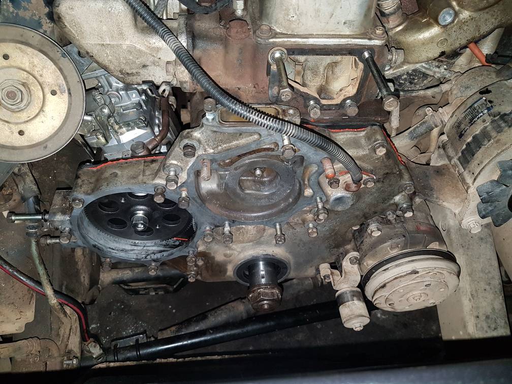

Finally got all the surfaces cleaned up properly, took all afternoon. Ready to start putting it back together tomorrow.
Progress!
http://www.nissanpatrol.com.au/forum...2018/01/78.jpg
Got the sump and balancer back on today and timing cover all torqued up. Should have the motor all back together tomorrow but don't have enough oil or coolant to run it.

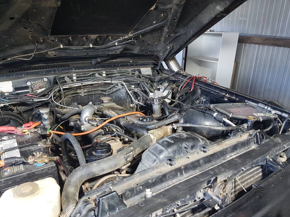

Nearly there.... http://www.nissanpatrol.com.au/forum...018/01/110.jpg
Got it running tonight and there are no leaks so far.

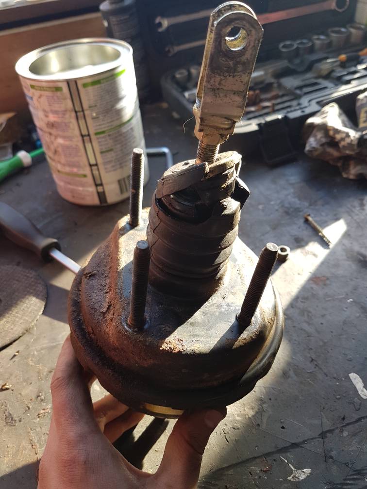

I am having an issue with vacuum though which was present before I started this job. I have no vacuum assistance in the brakes or clutch.
There is vacuum to both though but I'm not sure if it's enough? I wouldn't imagine both boosters going faulty at the exact same time.
Think I found my vacuum problem. It's a strange one though. If I block the hose going to the clutch booster then I have brakes working again. If I block the hose going to the brake booster I still have no clutch.
The 1 way valve on the brake line works as It should.
I pulled the clutch booster off and this is what I found.
