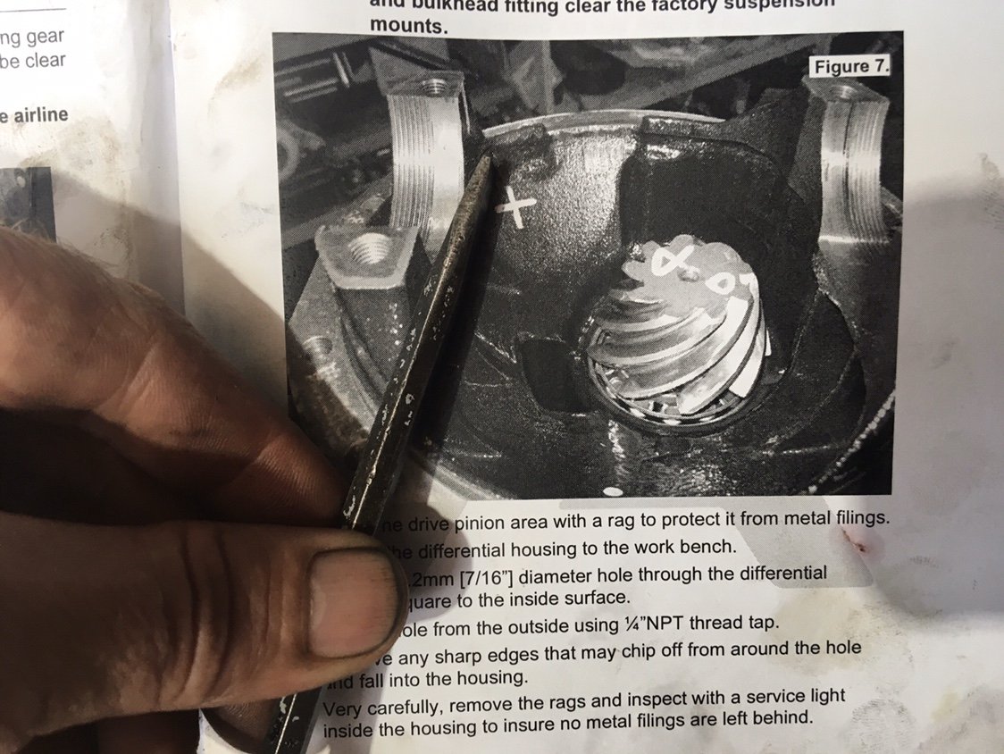

He only just managed to 90 degree bend the internal copper air locker line into the hole we’d tapped from ARB instructional picture interpretation.
http://www.nissanpatrol.com.au/forum...019/12/223.jpg
Be careful here folks as the picture is deceiving I believe!
http://www.nissanpatrol.com.au/forum...019/12/224.jpg
Really should be on a straight line down the inside of the diff housing unlike whats done is done now.
