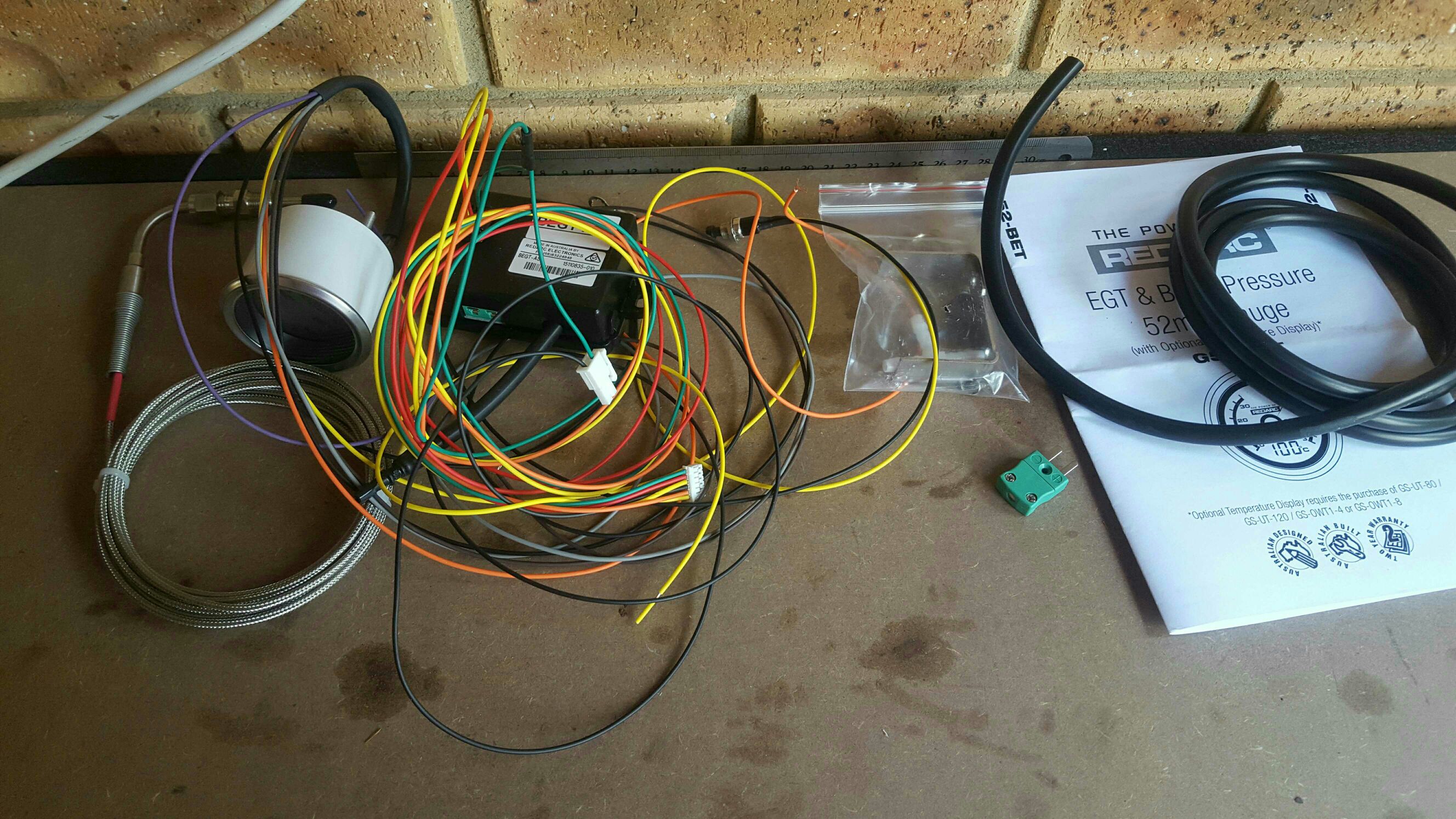

Afternoon spent wiring the gauge up. As it sits now everything is ready to go just waiting for a new water sensor tomorrow morning, and getting the EGT bung tapped to suit the probe thread. And then shes a goer !!
Also as per Mudskis advice, I have now got a 1/8NPT coolant sensor coming tomorrow morning, and I picked up a NPT to Metric reducer, so the sensor should go nicely.

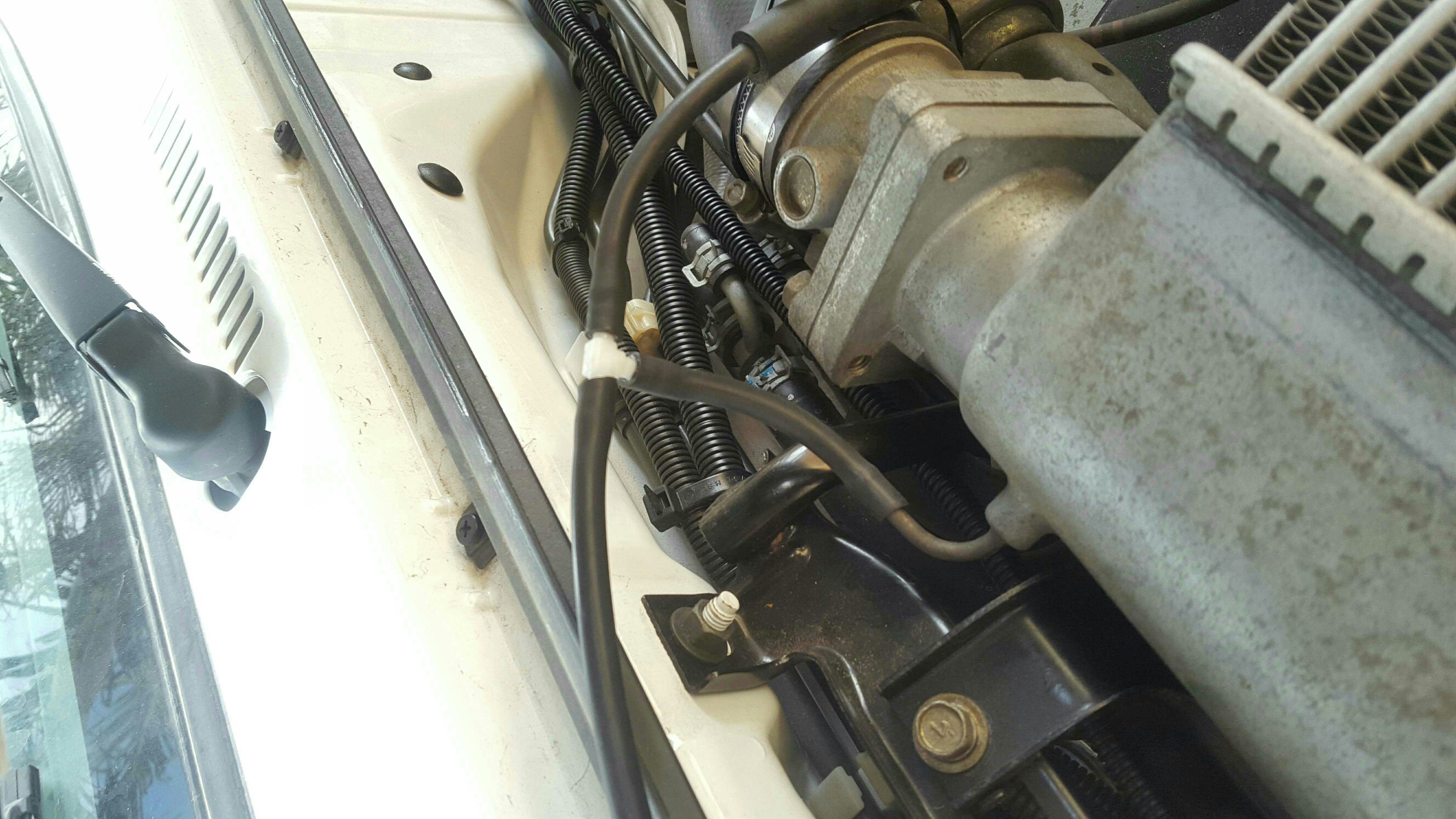

Just confirming with those with a stock ic, teeing off this little hose at the back is accurate enough? ??
http://www.nissanpatrol.com.au/forum...2015/12/87.jpg
Tapatalked from S6
Yep thats fine mate for your boost gauge.

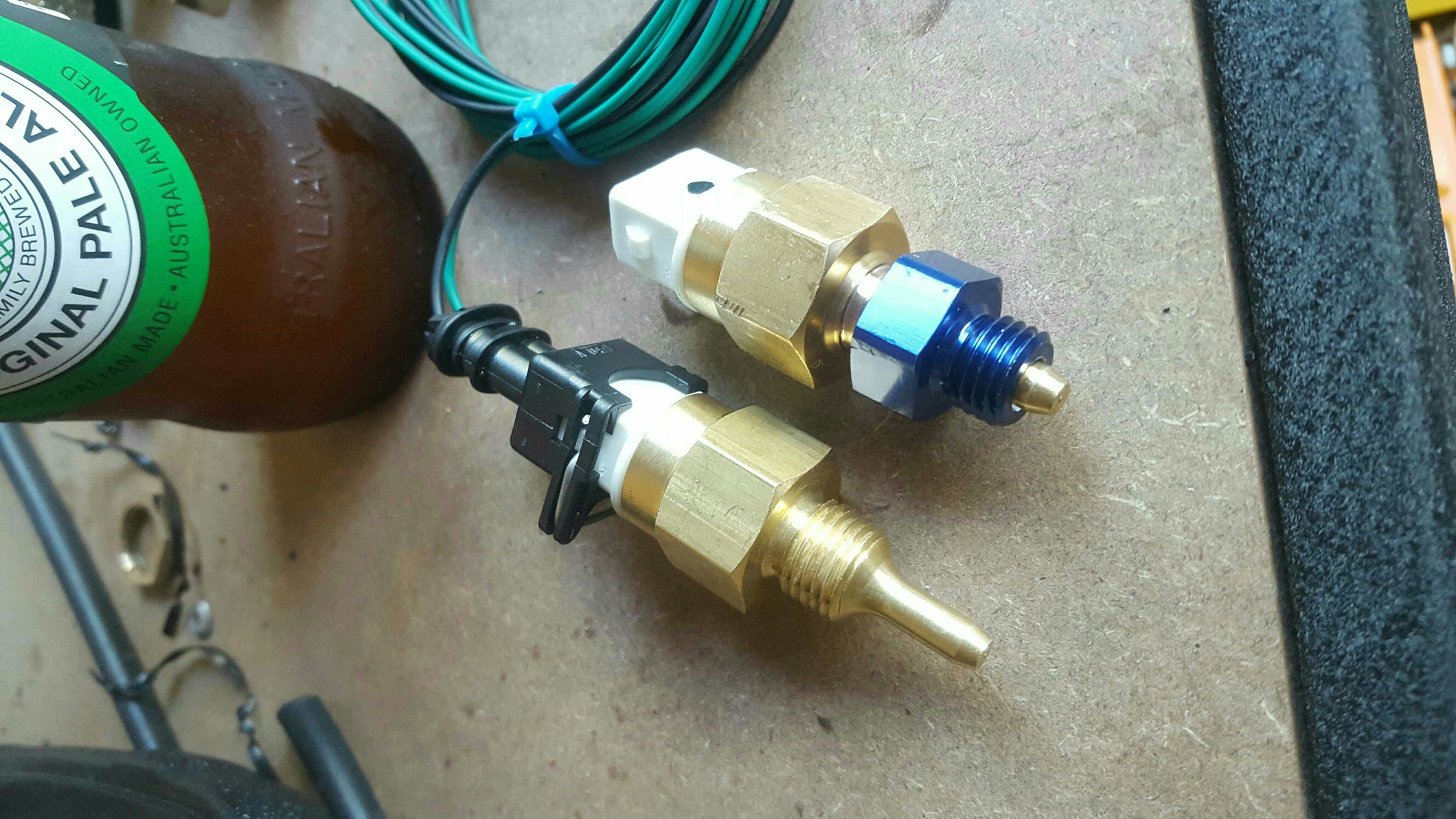

Another small hurdle the sensor was super tight to get into the adapter, even though it was a correct thread .
Had to drill and open the adapter a bit so the tapered bit of the sensor probe would fit .
But even then only 3mm of probe is sticking through . Wonder if this will be enough to pick up temperature OK? ??
http://www.nissanpatrol.com.au/forum...2015/12/90.jpg
Tapatalked from S6
It should be fine. An aftermarket gauge is good to yse in conjunction with the factory unit. You will get to know what temps it runs at and then moniter it. Usually the part of the probe that does all the work is in the very tip anyway.
As for putting it in just leave the rad caps on and you will only lose a small amount. And be quick :p.
Did they give you some sealing washers with those fittings?
Little tip you may or not know when using brass /alloy fitting
is to scruff up the thread so the tape doesnt turn on the threads.
Either scrape with a hacksaw blade or put the fitting in some footprints and tap on the ground.
Thanks John.
Had no idea I had to do that.
It was really tight after 2 turns or so whereas another male thread went in no issues.
Picking up another adapter soon and I'll gauge it from there.
This new adapter is brass where as the blue one I have is soft metal probably ally of some sort.
Tapatalked from S6
some may be tapered where others are straight threaded
