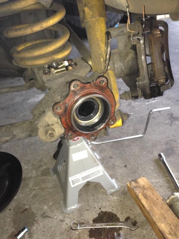

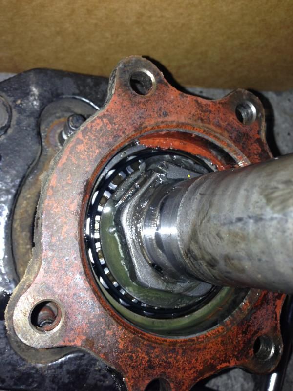

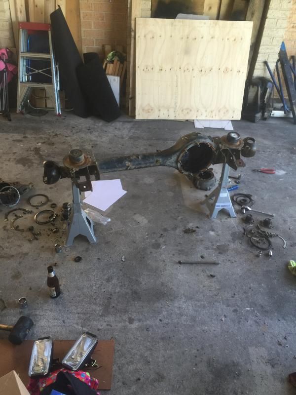

Cheers. Changed the oil seal on the rear axle. Looks like at some point it's had it's rear bearings replaced. By a butcher by the looks of it...
http://img.photobucket.com/albums/v9...06E6152E07.jpg
http://img.photobucket.com/albums/v9...5B4BBF6609.jpg
http://img.photobucket.com/albums/v9...6FF31D38ED.jpg
But either way, bearings feel good so a quick re-grease and it's all back together again.

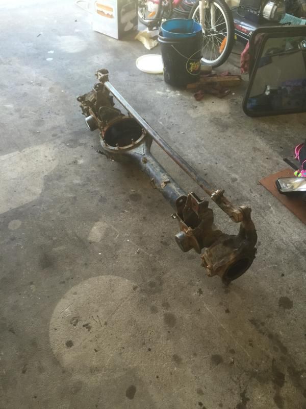

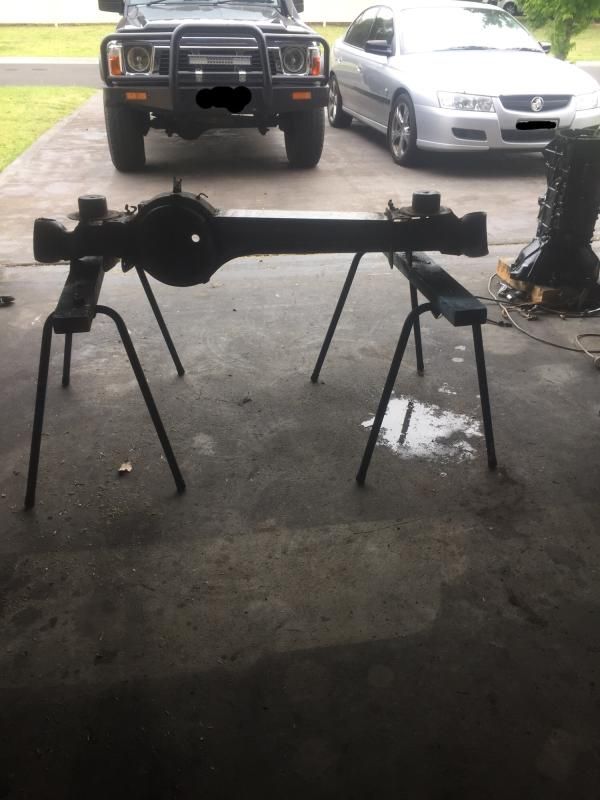

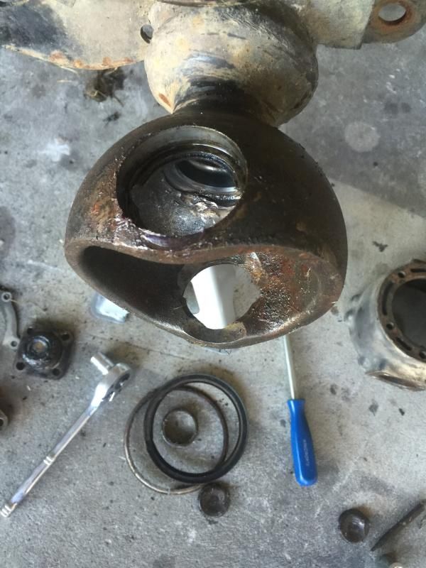

Bought a front diff housing for almost nothing😃. Plan on cleaning it up and laminating it, then will Put new bearings and seals into it and install it onto the patrol.
http://img.photobucket.com/albums/v9...424BEBB2BE.jpg
http://img.photobucket.com/albums/v9...9329157E96.jpg
http://img.photobucket.com/albums/v9...2F3A624102.jpg

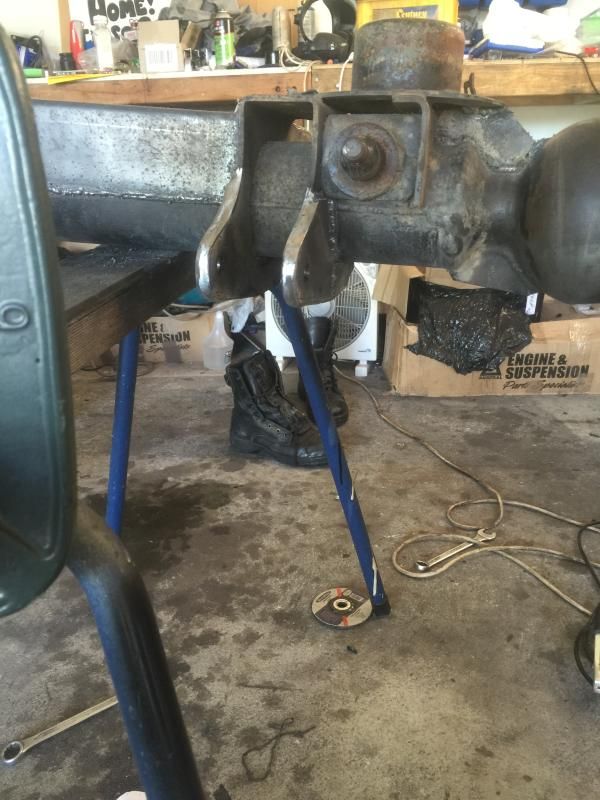

Wondering if anyone has ever braced the radius arm mounts like this? Overkill?
http://img.photobucket.com/albums/v9...322E16BC50.jpg
That reminds me, those who have welding experience, how do I avoid welding a bend into the diff when putting the top brace onto the passenger side tube?

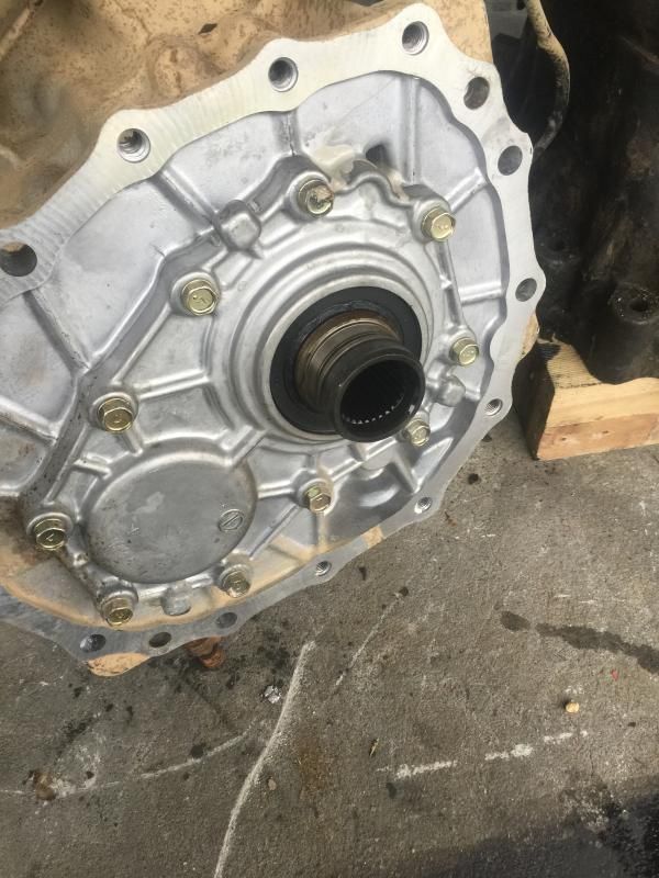

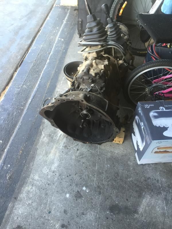

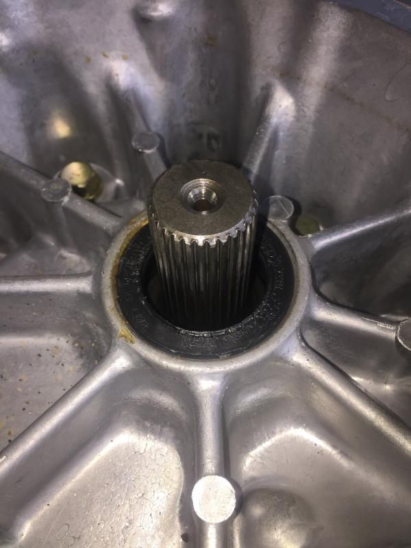

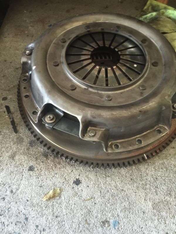

Picked up a clutch and freshly machined flywheel that had been installed for 1 week. Apparently the bloke ran the engine without oil and killed it. Score for me.
http://img.photobucket.com/albums/v9...05939D9EE5.jpg

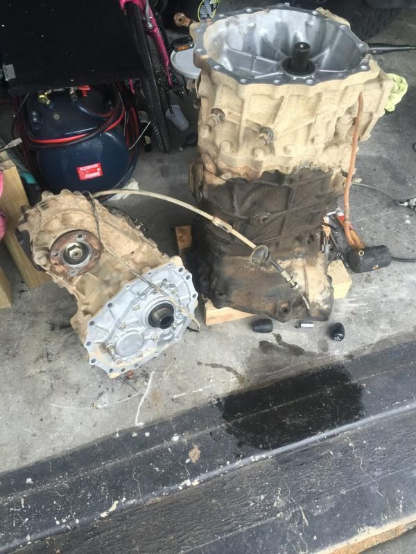

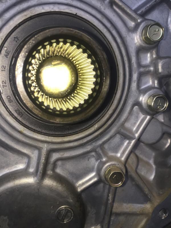

Also grabbed a gearbox with half the mileage that mine has.
http://img.photobucket.com/albums/v9...D502D02FB6.jpg
Picked up the lot for $350. Stoked!
Tell my wife that I have to and ill be right over.
By the way, good luck!! :)
Parksy,
How old is the box and transfer, as the seals and joint look immaculate....
Mic
I was told 230000km. Feels good when shifting through the gears and the input shaft has zero play. Going to be a vast improvement compared to my box, which I thought was ok until I felt this box... Oh that sounds dirty...

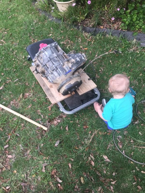

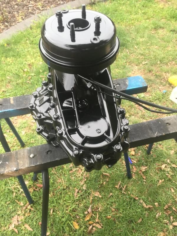

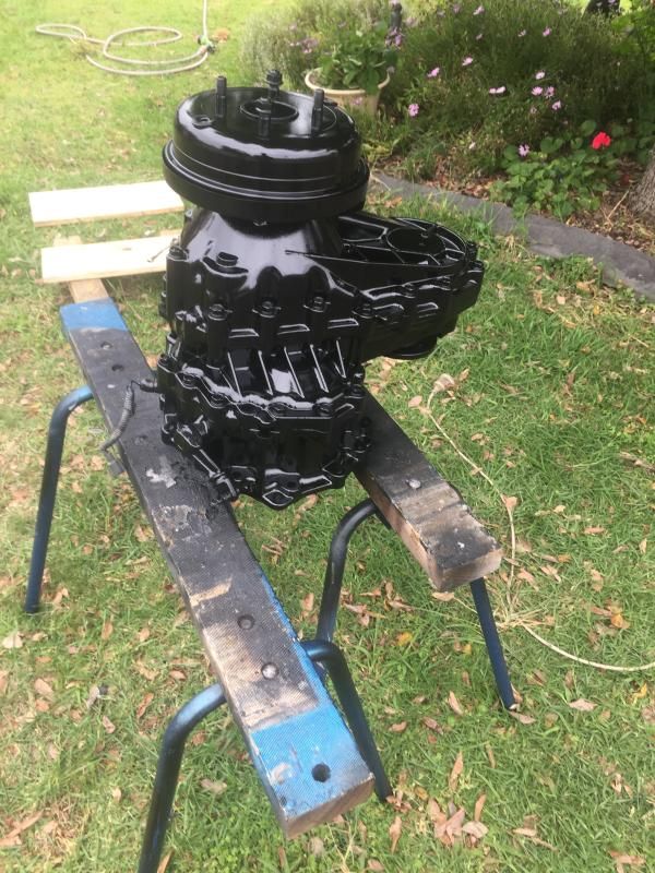

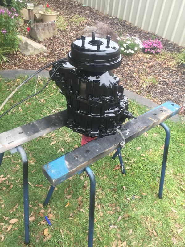

My boy doing a great job of cleaning the transfer box. If there's power tools operating then he's gotta be there. Love it!!
http://img.photobucket.com/albums/v9...784C4B08B3.jpg
haha cute!!!!
Shiny shiny.
http://img.photobucket.com/albums/v9...F712358A42.jpg
http://img.photobucket.com/albums/v9...A6CA20C7A1.jpg
http://img.photobucket.com/albums/v9...C38B5483EB.jpg

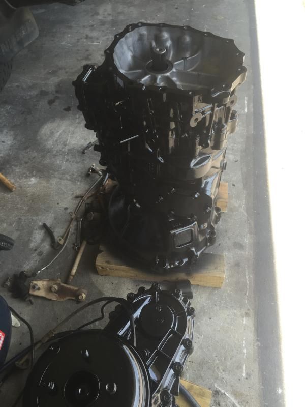

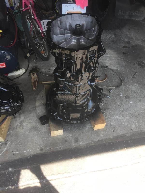

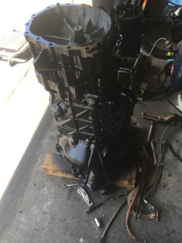

Will clean and paint the main transmission tomorrow then it's time to laminate the front diff.
http://img.photobucket.com/albums/v9...38F2BF1654.jpg
http://img.photobucket.com/albums/v9...3B9DC6A9C2.jpg
http://img.photobucket.com/albums/v9...9E74E560AE.jpg
The majority of the dirt and oil and crap somehow landed on me. Took about 30 mins of scrubbing in the shower to get it off. But it's looking good now and can sit there for a few months to degas until I can be bothered to chuck it into the car.

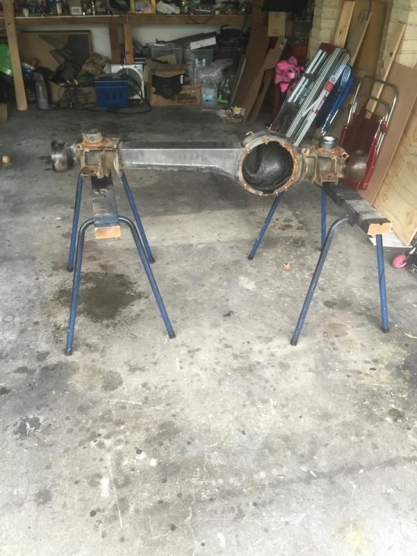

Diff laminating in progress. Has been a good day.
http://img.photobucket.com/albums/v9...636A7BA3E8.jpg
Square diff tubes look good.
http://img.photobucket.com/albums/v9...D59FBBCA89.jpg
Looks the goods, Parksy. Is the lamination fully sealed or is air allowed to circulate to keep the moisture at a minimum?
It is fully sealed, but I'll drill a hole in the top and put some oil in for protection then chuck a rubber bung in.

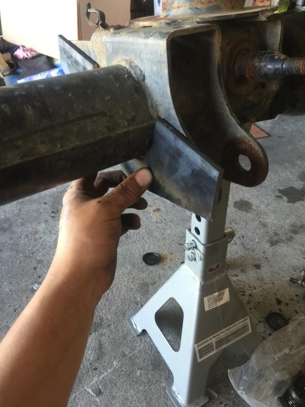

6mm plates welded on both sides of the radius arm mounts. Don't think ill be elongating these holes in a hurry.

I really enjoy welding. Feels very rewarding when it just works nicely. Unfortunately in my job, very little is welded on aircraft, it's all alloy and rivets.

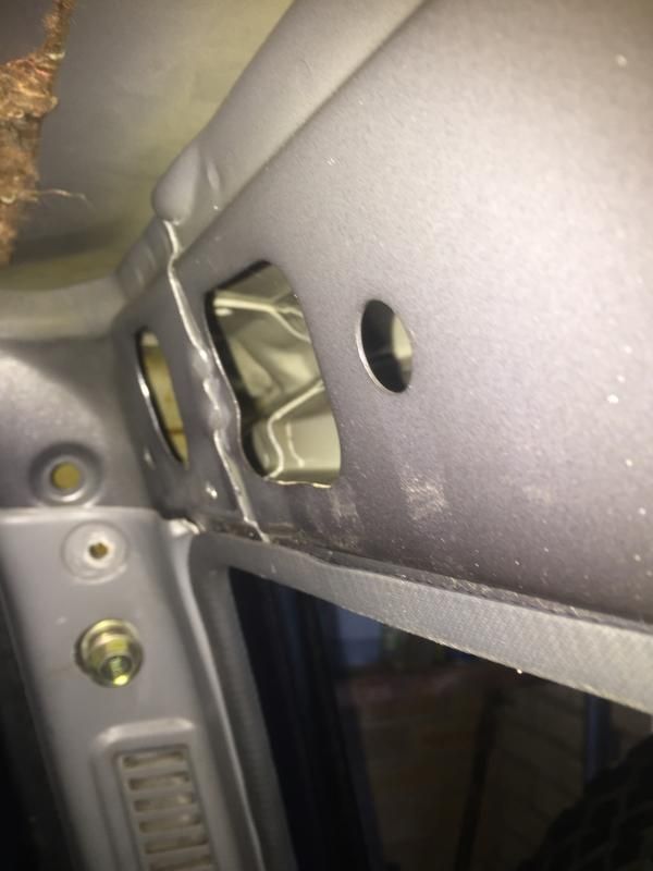

Noticed that the metal frames that run on the insides of the roof are glued onto the external skin. Some of the joins had delaminated which would cause a knocking sound when flexing. Nothing that some sikaflex would fix though.
http://img.photobucket.com/albums/v9...F10EDB0778.jpg
Filled the roof supports with 3 and a half tubes of sikaflex and started with the sound deadener.
