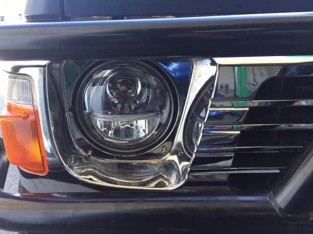

My headlights have been playing up, I assumed it was just the eBay cheapies so bought a set of ADR approved Narva LEDs.
Fitted the new ones and had the same issue, had 8 volts at the R/h headlight, turns out it was the headlight switch ��
Replaced that and tested, all works now
