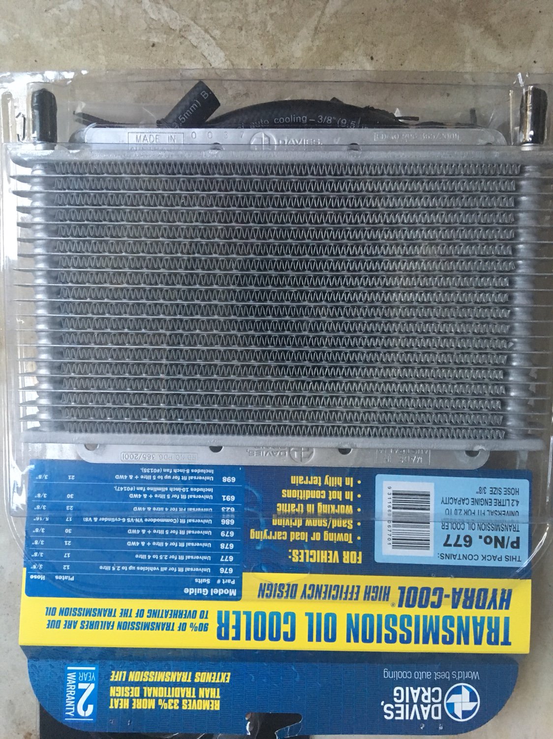

Possibly the slowest modification ever I’ve undertaken, quick update though. Finally found/purchased a suitably sized ‘Davies Craig-Hydro Cool’ http://www.nissanpatrol.com.au/forum...2017/11/29.jpg Made for autos but hoping this will suffice on the old 1999 power steering coolers and hard lines removal to make way for the twin Serco oil coolers install thereafter.
Mark, check your system pressure on both sides of the pump. These fittings are hose clamp style by the looks of it, and I think the ones you have now are crimped. I think the supply pressure is around 1300psi from memory - from my earlier investigations on nissan Patrol PS pumps and drivers for the MileMarker winch. I think these things are designed for a very moderate low side pressure - others may know more of course but worth it to check before blowing a hose especially when loaded up against a rock ledge.
Thanks mate :-) ! The current hard lines (stock GU believed) are sectioned in places along by factory flared to rubber with only worse than hose clamps, (those crappy steel plier compress release jobbies) :-(
Coolers are all on the low pressue side from what I have seem in most cars Phil. Never seen any finned heat transfer unit in a car capable of holding much more then 20psi haha.
