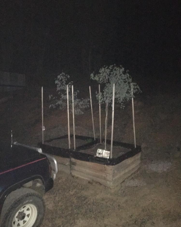

12 month tests update (weekend projects:-) running a Soggy (Unnatural) Potting Mix Southern Red Ironbark species versus a Yellow Box heavier final stable timber sapling. By far the Yellow is a better doer in these conditions and will grow taller/straighter for a shipload better return on Future Hippy’s unfunded self investments [emoji2961]

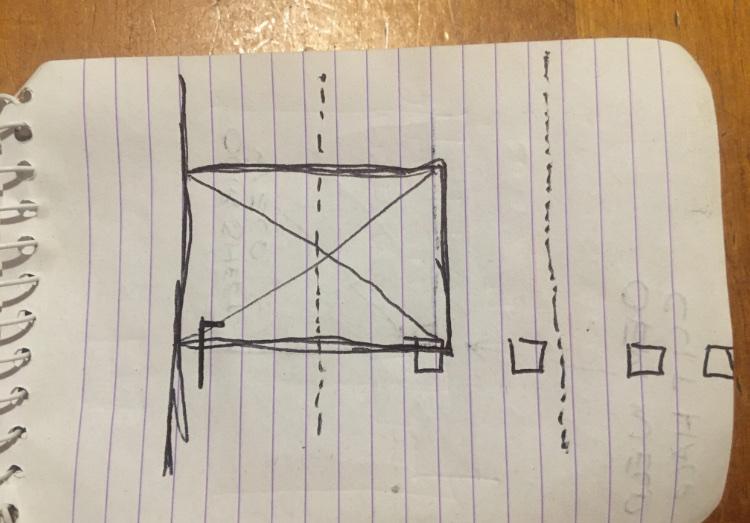

@MudRunnerTD seeing as it's hanging do you think I need a diagonal brace on the door?
Looking great mate. The door is hanging across rhe top so bracing is probably not needed. Easy to retro fit later is it needs it.
Once the frame is sheeted it will be great, won't need the bracing unless it's super heavy or being flogged back and forwards. The door sheet will smash it.
Far from a builder Nicco Mate, and struggling on a little screen to see properly, slider doors?
In my nuffy experience, my double shed sliders, wide open side have nearly taken out half of the hills when winds got out of control. Closed ‘deep’ concrete dropbolts definitely saved the days in storms and user rules of either open full and or closed are needed.
Go crazy and add a shipload of extra slider guides for say 1/4 - 1/2 - 3/4 open to secure the flappy bottom.
I suspect bracing diagonally would be needed more than ever as my kit bought many years ago does have Brother [emoji106][emoji106]

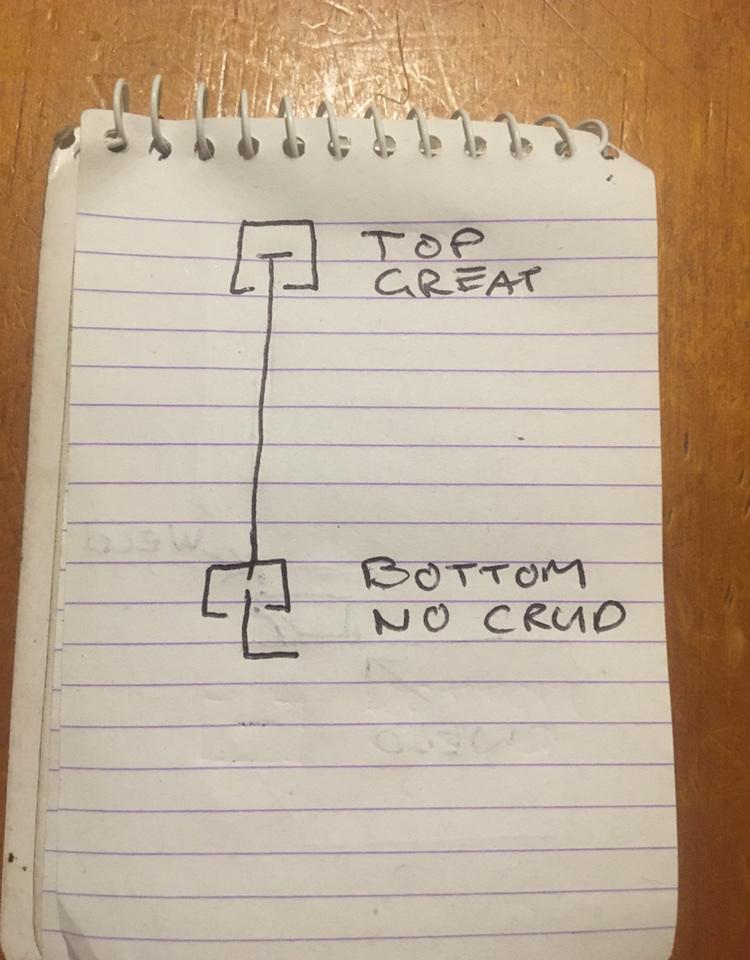

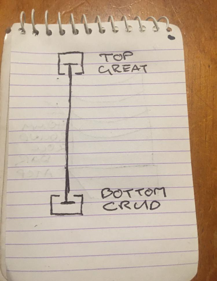

Hey mate, it's one slider door, 2600w. I am yet to install a lower slider track, I need to grab some from work. The top track is from an industrial castor manufacturer in Clayton, they had some good gear there, and it was bloody well priced. Unfortunately they didn't have the guides so I'm going to install some 50mm angle and use that to guide the entire door. Should be able to capture the entire door on open and capture each end on close, I've left 100mm overhang either side of the door. Add that with a pad bold either side the door hopefully won't go anywhere.
Milwaukee blower to clean out the base tracks each morning, none of that Makita blue crap [emoji90] and or run an easier exact top track below for upside down L base guidance. Give me 5, will scribble pic [emoji23]
