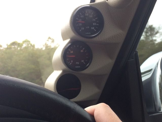

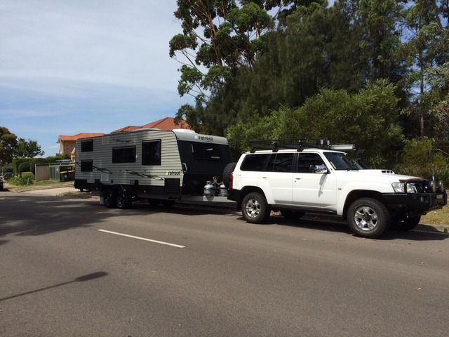

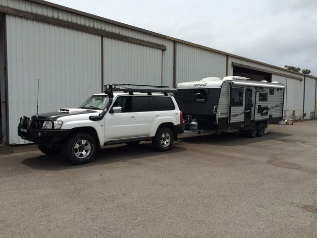

We took the new rig for a quick spin down the coast over the weekend. Left Sydney around 3pm on Friday with a balmy 35 deg air temp. Everything was going well untill we hit a couple of the bigger hills just north of Wollongong, when the EGT's hit 500 and the temp gauge started heading north, time to back off and "float" it as best as possible to the tops of hills.
Van weights in pretty much at 3T.
http://i1083.photobucket.com/albums/...psxidbylea.jpg
http://i1083.photobucket.com/albums/...pstua3dhml.jpg
Had a great weekend and time to head home this arvo, much cooler, about 25 deg and nice cool wind. Everything was sweet, then we hit Mt Ousley, all temps went ape shit, EGT's 550 and water temp went out of the "normal" range on the Nissan gauge. Again backing off, and off, and off and cruised over the top in 3rd on bugger all throttle. I was running 3rd up the whole hill on about 1/4 to 1/3rd throttle at about 70km/hr, this gave me about 2,400 revs, give or take and she still got hot. This also occured for the next 3 hills over the next 5-6km, being Picton hill, Cateract ( spelling??) and Bellambi. On all ocassions it very quickly recovered once clearing the top, but it got way too hot for my liking and needs modding.
One thing I'm not sure off, when I towed it home from Newcastle I didn't have the bonnet protector on and the temps stayed pretty good, it was also a much cooler day. This time I was running the bonnet protector, maybe this was mucking up the airflow into the scoop and hence intercooler effeciency???
Anyway, time for a new radiator. 2 or 3 core, Alloy or copper/brass????? Any suggestions from those who have had success.
