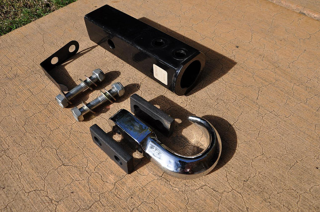

No probs will get it sorted , this is the picture of the one to suit the GQ,
You can also bolt a black hook to it if need be.
Edit or you could bolt one of these in line with the chassis rails on the
front of Bullbar either side of winch
@ MitchM these are the 2 styles I'm thinking will fit, the folded fit under the chassis rails and the other bolts to the outside of bulbar.
That hook one I've been using for years, had another on my other 4x4 as well great around camp and on the tracks for quick hook ups, but don't make them any more.

I'm curious about the 'bush hoop' item. I have lots of experience with recoveries and ran Superior Engineering dual 16mm plates on my last Patrol (I'll take over-engineered over adequate any day), but I'm no engineer. So, call it fear of the unknown, but using an eye bolt that is designed for static load (lifting) in a shock load application doesn't make a lot of sense to me.
Have you tested the M20 eye bolt in isolation, or as part of the 'bush loop' assembly? How is the eye bolt fastened to the 50x50 block? How exactly was the product tested?
I've got to be honest, although I can see that your other recovery points are as stout as they come, I look at this item and I don't see 'safe' - I'm not the type to stay quiet about stuff I'm uncomfortable with, hence this post. Looking forward to your response.

Thanks for your responses John and Kallen. As I mentioned this is something we haven't seen done with recovery points before.
I recall when these ones came out, I already had a billet-style 50x50 hitch receiver but I went out and bought one of these just to see how they were put together:
http://www.nissanpatrol.com.au/forum...2014/05/25.jpg
I'd like to see a bush loop disassembled to show how the components are fitted together.

I didn't imply that you made the one in my photo, John. I used it as an example of something a bit different, which is what your bush hoop is. I asked for more information on how the bush hoop is assembled, you have chosen to not provide that information and that is your prerogative.
People making their own recovery points is irrelevant; they are not selling those home-made recovery points to the public. Out of scope in this discussion.
