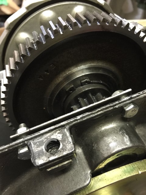

A couple of pics of my winch from the weekend. Tops off so thought of this thread.

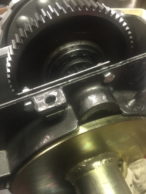

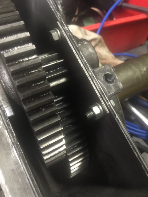

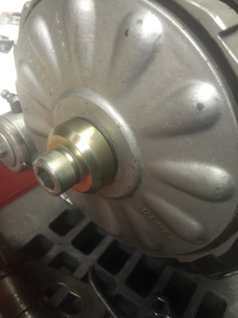

Here is a couple of pics of the Gigglepin (GP) brake shaft difference. It's far more than just a drilled and tapped shaft.
http://www.nissanpatrol.com.au/forum...2016/07/43.jpg
The shaft also locks up the second Gear. The main gear is on the drum so the second gear is on the brake shaft.
There is a packer that goes between the casing and the gear the the shaft has a rebate for circlip.
http://www.nissanpatrol.com.au/forum...2016/07/44.jpg
There is zero play of the second gear on the shaft. Very cool.

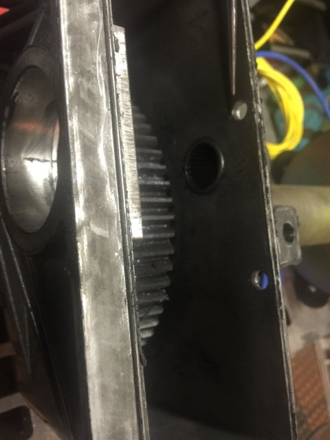

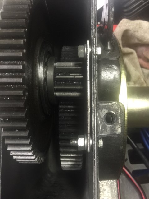

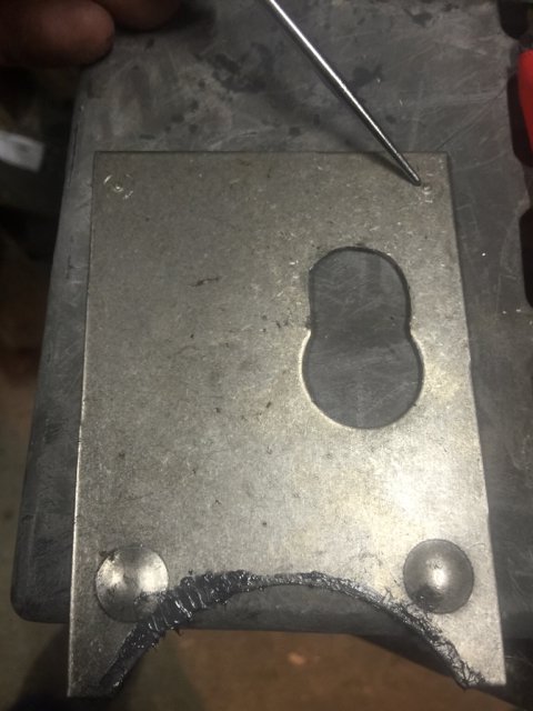

Also I have drilled and bolted the retaining plate to the case. I have had this plate fail on me once so this mod was a no brainer.

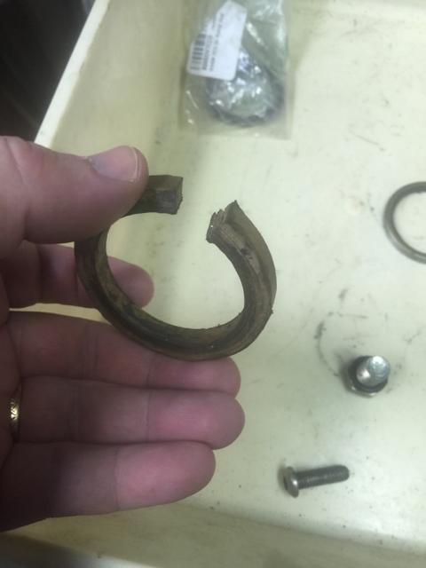

Also VERY IMPORTANT. If you have rebuilt a Himount you will have a cardboard pack used to insert the oil seal. You should keep this in your spares kit and carry it. Essential if you have to strip your winch on the tracks!! I might have stripped mine n the bush a couple of times.!!
