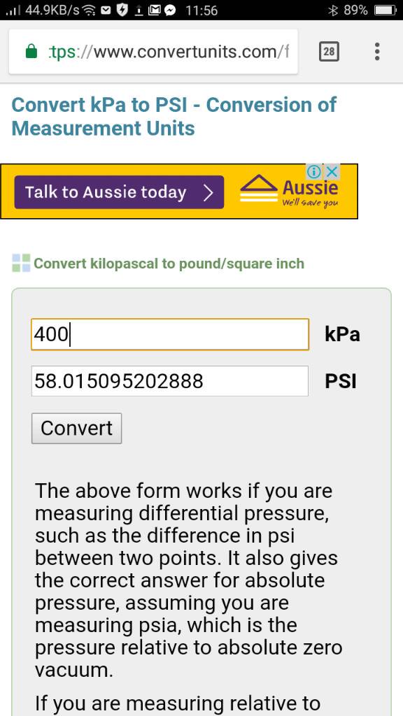

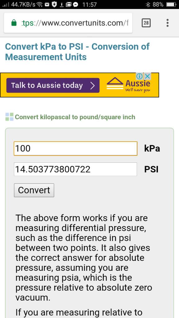

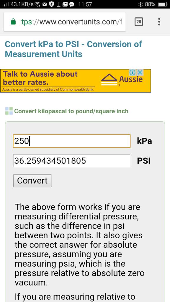

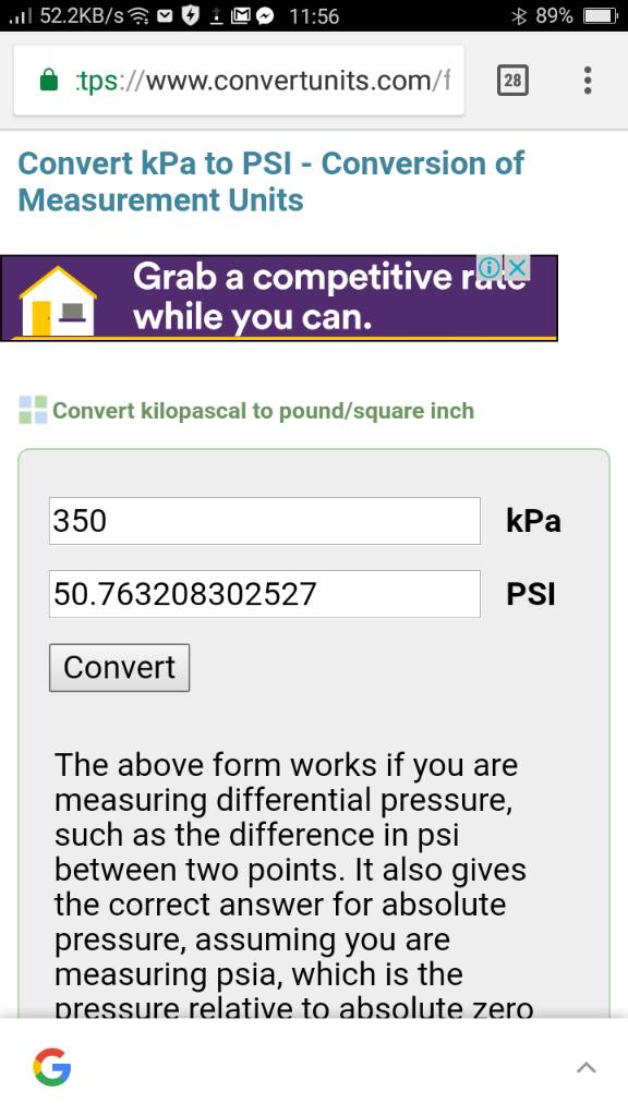

I took a couple of videos. Sorry they may be a little long. The gauge is in kpa below is some screenshots of different values.

At this stage I think that I'm alright. Looks like the Electrical gauge is inaccurate when I left off the accelerator, under no load.
